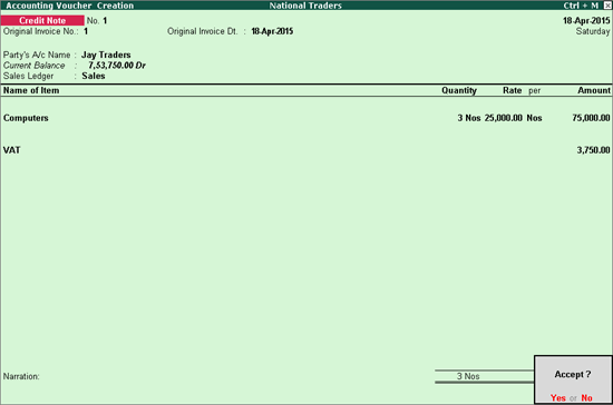

In Tally.ERP 9, you can record a credit note to account for sales returns within the state of Maharashtra.
1.    Go to Gateway of Tally > Accounting Vouchers > Crl+F8: Credit Note.
2.    Enter the Original Invoice No. and Original Invoice Dt of sales invoice in their respective field.
3.    Select the required Party’s A/c Name from the List of Ledger Accounts.
5.    Select the common sales ledger in Sales Ledger field .
6.    Select the required nature of transaction in VAT/Tax Class.
7.    Select the required taxable stock item.
8.    Enter the Quantity and Rate.
9.    Select the required common VAT ledger  grouped under Duties & Taxes in which the options,
●     Type of Duty/Tax is set to VAT.
●     Percentage of Calculation is set to zero.
10.  Set Provide VAT Details to Yes or No as per requirement.
11.  Press Enter to save.
