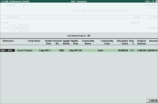

4.    Credit the ledger created under the group Current Assets and enter the value in the Amount field. The completed transaction screen appears as shown below:
5.    Press Enter to save.
