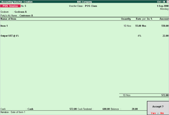

The Accounting Voucher screen appears as shown below:
9.    Press Enter to save.
