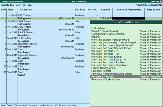

Tax rate/tax type not specified
Displays the count of transactions for which the rate or tax type is not selected in the item/ledger master.
To resolve this exception
1.    Select the exception Tax rate/tax type not specified.
2.    Press Enter. All the transactions of the exception type are displayed. The Exception Resolution screen appears as shown below:
Note: Based on the state specific tax structure, the columns are displayed. The column:
♦   Addl. Tax Rate appears for Gujarat and Uttar Pradesh.
♦   Surcharge appears for Punjab and Haryana.
♦   Cess for Kerala VAT.
3.    Select the Nature of transaction, if not provided.
4.    Enter Rate of Tax, as required for each transaction.
5.    Press Enter to save.
Note: Click X: Exclude Vouchers to exclude the voucher from forms and annexures.

To update the information and resolve voucher exception at voucher level
1.    Click I: Item Exceptions.
2.    Navigate to required exception type and press Enter from Total Masters column to display Exception Resolution screen, as shown below:
♦   Surcharge appears under each taxable transaction for Punjab and Haryana.
♦   Cess under each taxable transaction for Kerala VAT.
3.    Select Nature of transaction.
4.    Enter Rate of Tax.
5.    Press Ctrl+A to accept.
