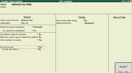

1. Voucher Type - Material Out (RM)
This voucher Type will be used by the Principal Manufacturer in Job Work Out process for recording the Transfer of Raw Materials to the Job Worker.
To create the voucher type
1.    Go to Gateway of Tally > Accounts Info. > Voucher Types > Create.
2.    In Name field enter the name of the Voucher Type. For example, Material Out (RM).
3.    In Type of Voucher field select Material Out from the List of Voucher Types.
4.    Select Automatic in Method of Voucher Numbering field.
5.     Retain the default setting for other options.
6.    Set the option Use for Job Work to Yes.
Note:
1. Use for Job Work option will be displayed in Material Out voucher type when the option Enable job order processing is set to Yes in F11: Features (Inventory Features).
2. Set the option Use for Job Work to Yes if you want to use the voucher type to record Job work transactions.
7.    Retain No for the option Use for Job Work In.
8.    Set Print after saving Voucher to No.
9.    Enter Default Jurisdiction as Bangalore.
Note: Set the option Use for Job Work In to Yes if the Job Worker wants to use the Material Out voucher type to record the transfer (out) of Finished goods/ scrap/ Co-product/By-Products.
The completed Voucher Type Creation screen is displayed as shown:
10.  Press Enter to save

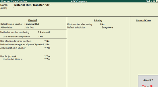

2. Voucher Type - Material Out (Transfer/FG)
This voucher Type will be used by the Job Worker in Job Work In process for recording the Transfer of Finished Goods, Scrap, By-Products, Co-Products to the Principal Manufacturer.
2.    In Name field enter the name of the Voucher Type. For example, Material Out (Transfer/FG).
4.    Select Automatic in Method of voucher numbering field.
6.    Set the option Use for job work to Yes.
7.    Set Print voucher after saving to No.
8.    Enter Default Jurisdiction as Bangalore.
9.    Press Enter to save.

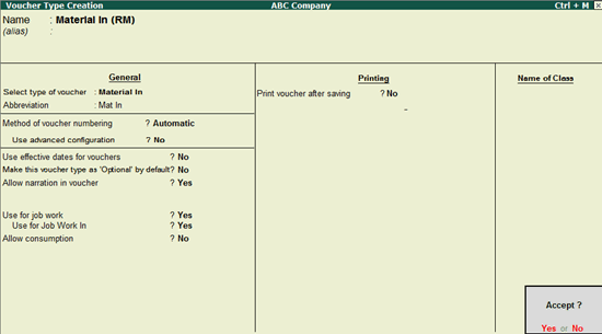

3. Voucher Type - Material In (RM)
This voucher Type will be used by the Job Worker in Job Work In process for recording the Receipt of Raw Materials from the Principal Manufacturer.
2.    In Name field enter the name of the Voucher Type. For example, Material In (RM).
3.    In Type of Voucher field select Material In from the List of Voucher Types.
7.    Set the option Use for Job Work In to Yes.
The completed Voucher Type Creation is displayed as shown:
8.    Press Enter to save.
Note: While creating Job Work In voucher type to account the receipt of Raw Materials by the Job worker, if the option Use Job work In is set to Yes Tally.ERP 9 will skip Allow Consumption field.

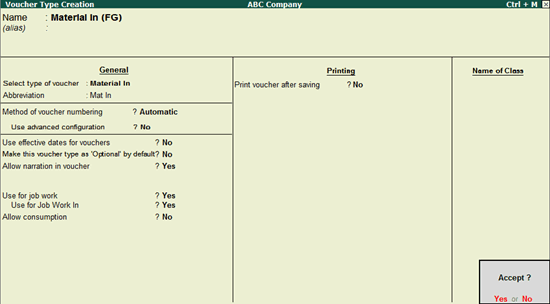

4. Voucher Type - Material In (FG)
This voucher Type will be used by the Principal Manufacturer in Job Work Out process for recording the Receipt of Finished Goods, Scrap, By-Products, Co-Products from the Job Worker.
2.    In Name field enter the name of the Voucher Type. For example, Material In (FG).
7.    Set the option Use for Job Work In to No.
8.    Set the option Allow Consumption to Yes.
Note:
1. Enable the option Allow Consumption in Material In voucher types, when the voucher type is used by the Principal Manufacturer to account the receipt of Finished Goods from the Job Worker.
2. When Allow Consumption is set to Yes, on recording the Material In voucher the Raw Materials used in the manufacture of Finished goods will be considered as Consumed and to that extent the stock will be reduced from the books of accounts.

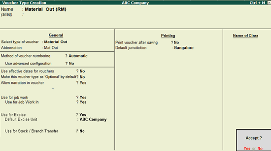

Create Material In/out Voucher Types - if Excise Applicable
8.    Set the option Use for Excise to Yes.
9.    In Default Excise Unit field select the Excise unit - ABC Company.
