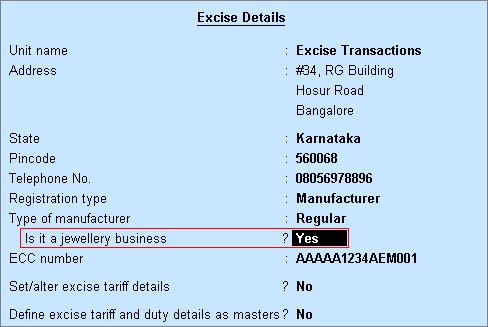

4. In the Excise Registration screen, excise details like Unit name, Address, State, Pincode and, Telephone No. will be displayed as entered in the Company Creation screen. These details can be altered, if required.
5. Select Manufacturer as the Registration type.
6. Select the Type of manufacturer, as required.
7. Enter ECC numberECC number is PAN based, and has 15 digits. The format of ECC no. is ABCDE1234HXM001.

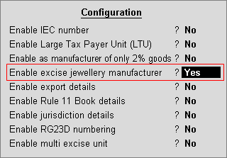

Note: For jewellery business, press F12: Configure.
1. Set the option Enable excise jewellery manufacturer? to Yes to display the option Is it a jewellery business? in the Excise Registration Details screen.
2. Press Ctrl+A to accept.
In the Excise Registration Details screen, set the option Is it a jewellery business? to Yes.
