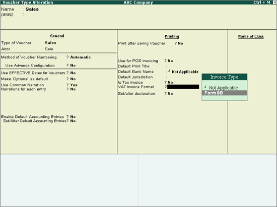

To configure sales voucher type for printing the invoice in Form 8B format
1.    Go to Accounts Info. > Voucher Types > Create.
2.    Enter the Name of the voucher type.
3.    Set Is Tax Invoice? to No.
4.    Set VAT Invoice format? to Form 8B.
The retail invoice voucher type appears as shown below:
5.    Press Ctrl+A to save.
