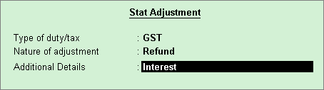

2.    Click J: Stat Adjustment.
3.    In the Stat Adjustment Details screen, select the options as shown below:
4.    Press Enter to save and return to the journal voucher.

Similarly, you can record the journal voucher by selecting the Additional Details in the Stat Adjustment Details as:
     Not Applicable, for refund of excess tax payment made.
     Penalty, for refund of excess payment made towards penalty.
     Late Fee, for refund of excess payment made towards late fee.
     Others, refund of excess payment made towards other dues.
