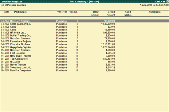

1.    Go to Gateway of Tally > Audit & Compliance > Audit & Analysis > Verification of Vouchers.
o     Select the required Voucher Type and press Enter.
o     Select the required Month from Voucher Monthly Register and press Enter.

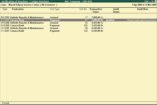

Note: To view the Ledger Vouchers report, the Auditor can press Enter on the Ledger name if displayed at the Verification of Vouchers report itself ( in case if the Ledgers are directly created under the Primary Group).
The Ledger Vouchers report displays the transaction details such as Voucher Type, Voucher No., Transaction Value, Audit Status and Audit Note for the selected Ledger.

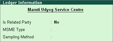

I: Other Info
Click on I: Other Info or press Alt+I to view the following details:
●     Whether this Ledger is identified as Related Party also?
●     Type of Enterprise if the Ledger is a Micro, Small or Medium Enterprise ?
●     Details of Sampling Method applied if any.

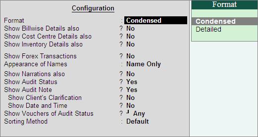

F12: Configure
Click on F12: Configure or press on F12 to alter the default display for the above report.
●     Show Narrations also: Set this option to Yes to display the Narration entered by the Client during the Voucher entry.
●     Show Audit Status: Set this option to Yes to display the Audit Status as selected by the Auditor during the Audit. This option is set to Yes by default.
●     Show Audit Note: Set this option to Yes to display the Audit Note as entered by the Auditor during the Audit. This option is set to Yes by default.
●     Show Client's Clarification: Set this option to Yes to display the Clarification Note entered by the Client for the Vouchers marked as Need Clarification by the Auditor.

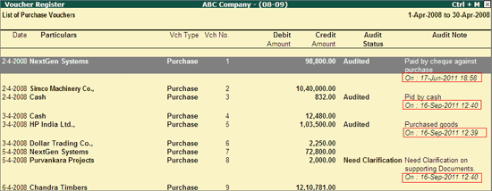

●     Show Date and Time: Set this option to Yes to view the audit Date and Time.
On enabling Show Date and Time the Ledger Vouchers report appears as shown:

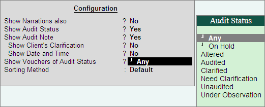

●     Show Vouchers of Audit Status: Select the required Audit Status for Vouchers (from Altered, Audited, Clarified, Need Clarification, Unaudited, Under Observation, On Hold and Any) to filter and display the Vouchers for the selected Audit Status.
