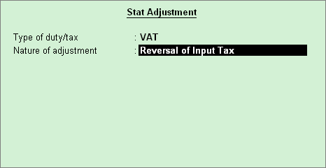

For reversal of claimed or availed input tax credit, a journal entry using Reversal of Input Tax as Nature of Adjustment can be recorded.
To record journal entry to account for reversal of input tax
2.    Click J: Stat Adjustment. In the Stat Adjustment screen,
o     Select the option VAT in the Type of Duty/Tax field.
o     Select the option Reversal of Input Tax in the Nature of Adjustment field.
o     Press Enter to save.
