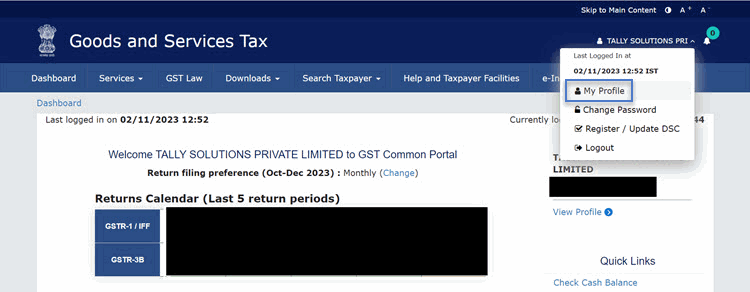

  1. Log in to the GST portal.
  2. Click your username in the top right corner.
  3. Select My Profile from the list of options.

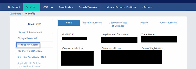

  4. In the My Profile screen, under Quick Links, click Manage API Access.
  5. Set the Enable API Request option to Yes.
