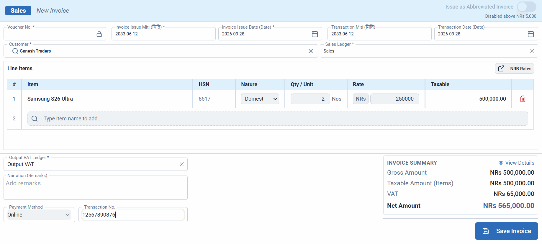

  1. From Gateway > click Transactions > and then click Sales Invoice.
    By default, the sales invoice opens in Item Invoice Mode.
  2. Enter the Invoice Issue Date and Transaction Date.
    By default, both dates are set to the current date. The Transaction Date can be the same as or later than the Invoice Issue Date, but cannot be earlier.
  3. Select the Customer.
  4. Select the Sales Ledger.
    By default, the ledger configured in the voucher type is prefilled. You can select a different ledger if required.
  5. Enter the Stock Item details.
    1. Select the stock item.
    2. Select the Nature of transaction.
      By default, the nature of transactions configured for the sales account is selected.
    3. Enter the Quantity and Rate.
  6. To view the Stock Item Description on the voucher, click Voucher Configuration and enable Stock Item Description.
  7. Select the Output VAT Ledger.
  8. Enter a Narration, if required.
  9. Select the Payment Method as Cash, Bank Transfer, Online, Cheque, or Credit.
  10. Enter the Transaction No. if you have selected the Payment Method as Bank Transfer, Online, or Cheque.
    Sales
  11. Click Preview to view the voucher before saving or click Save Invoice.

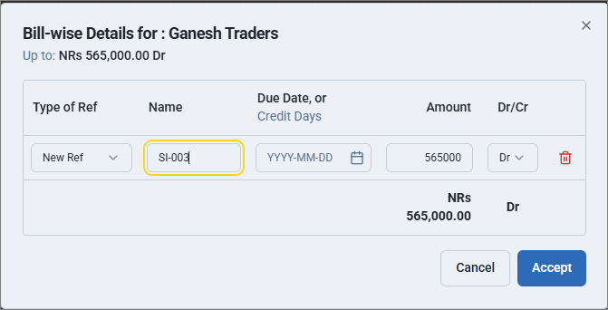

  13. Enter the Bill-wise Details.
    Bill wise sales
    1. In the Bill-wise Details for screen, select New Ref as the Type of Ref.
    2. Enter the reference number under Name.
    3. Click Accept.
  14. Select Yes to save the voucher.

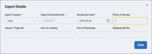

  4. Click Export and enter the export details.
    Fields marked with * are mandatory.
    1. Export Country: Enter the name of the country where the goods are exported.
    2. Export Declaration No.: Enter the declaration number assigned by the customs authorities.
    3. Declaration Date: Enter the date on which the declaration number was issued.
    4. Place of Receipt: Enter the place where the goods will be received.
    5. Vessel/Flight No.: Enter the vessel or flight number used to export the goods.
    6. Port of Loading: Enter the name of the port from which the goods were loaded.
    7. Port of Discharge: Enter the name of the port where the goods will be unloaded.
    8. Shipping Bill No.: Enter the shipping bill number assigned by the customs authorities.
