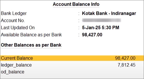

Getting Bank Statement and Bank Balance
Once logged in to Connected Banking, you can save a great deal of time of by doing the following in a matter of clicks:
