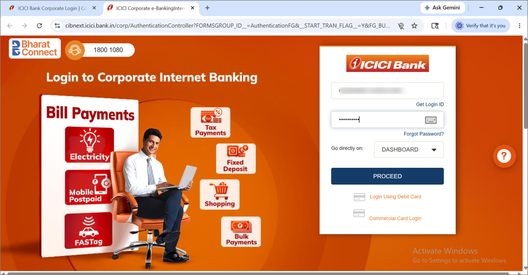

  1. Log in to the ICICI Bank portal.
    1. Open the ICICI Bank portal.
    2. Enter your Login ID.
    3. Enter the Password.
      ICICI CIB Portal Login

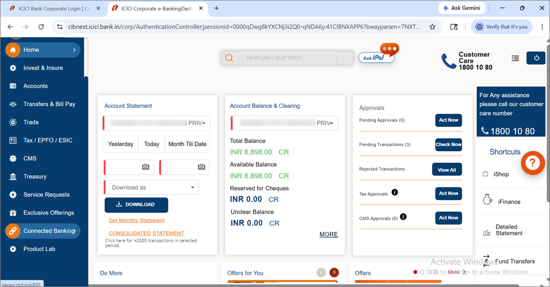

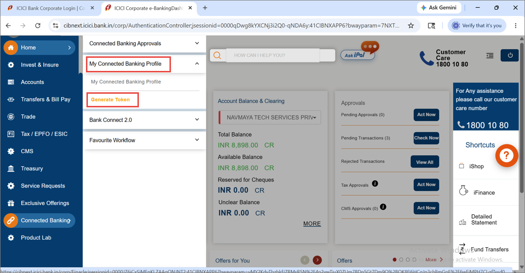

  2. Click Connected Banking.
    TallyPrime Connected Banking on ICICI Bank CIB Portal

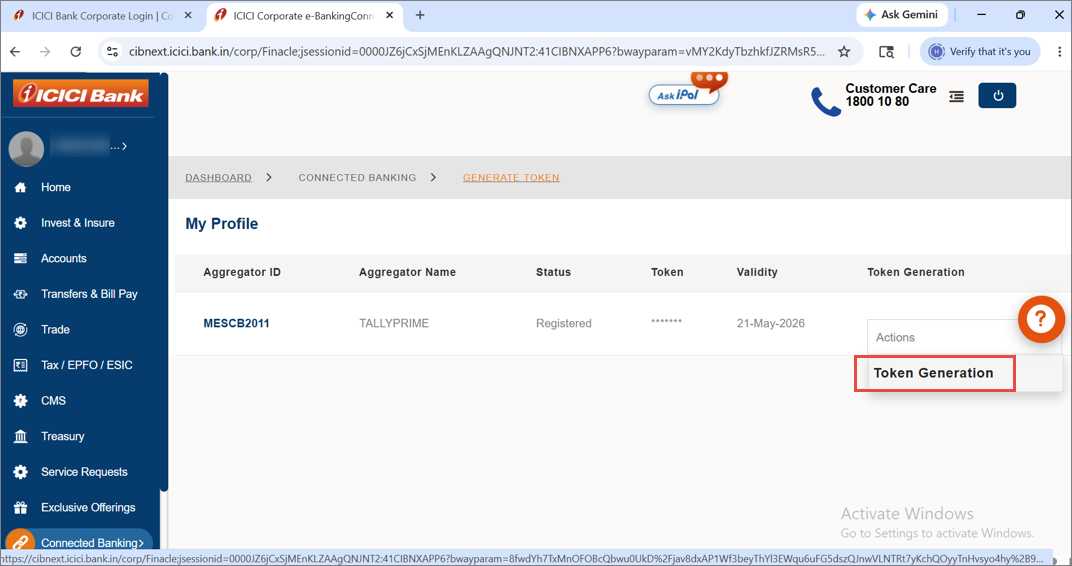

  3. Click My Banking Profile.
  4. Click Generate Token.
    Token Generation Under My Bank Profile on ICICI Bank CIB Portal
  5. Under Actions, click Token Generation.
    Token Generation for Online Payments Using Connected Banking in TallyPrime

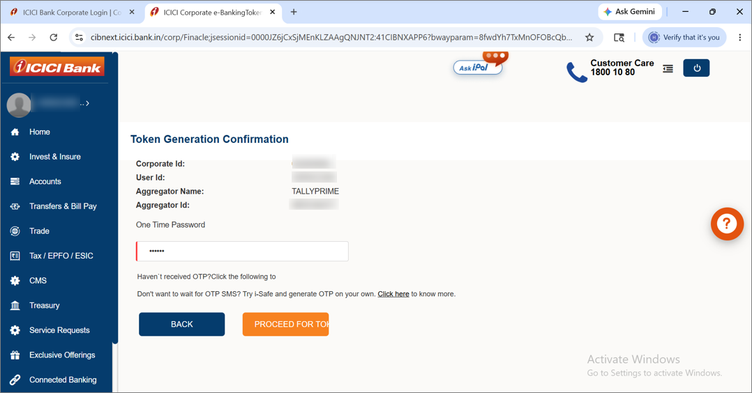

  6. Enter the OTP received on your mobile number.

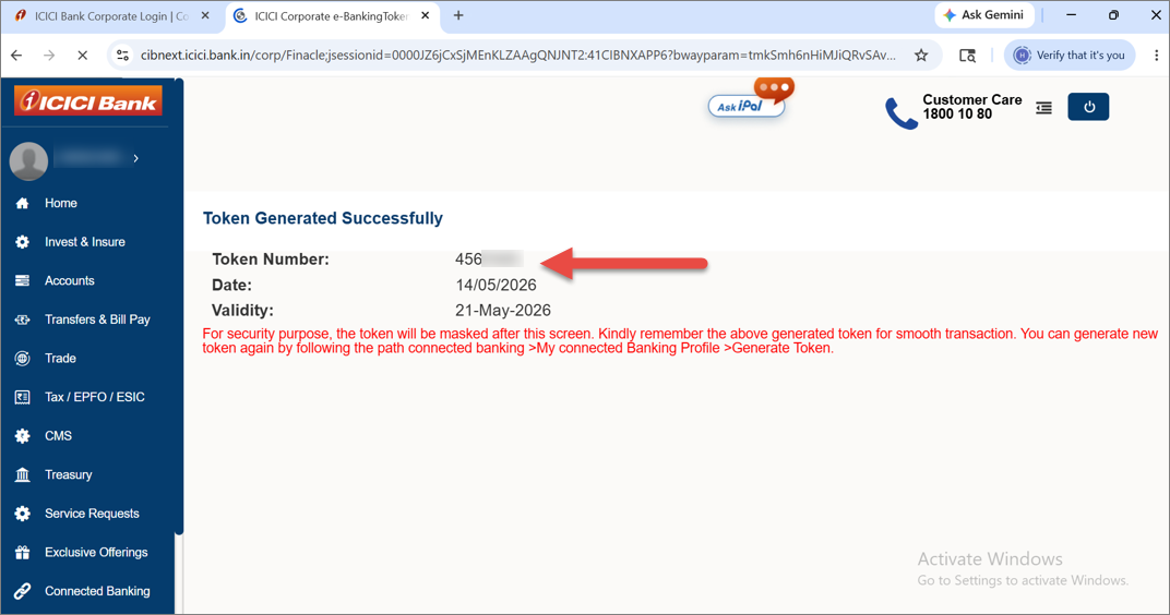

    The token gets generated.
    Token Generation Successful on the ICICI Bank Portal
Here are some important points to note about the token generated on the ICICI Bank portal for online payments using Connected Banking.
  • The token is valid for 7 days.
  • After this session on the ICICI Bank portal, the token gets masked.
    So, remember this token, as you need to enter it to initiate online payments using Connected Banking in TallyPrime.
  • If the token expires or you forget the token, you can always generate it again on the ICICI Bank portal.

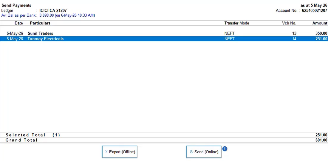

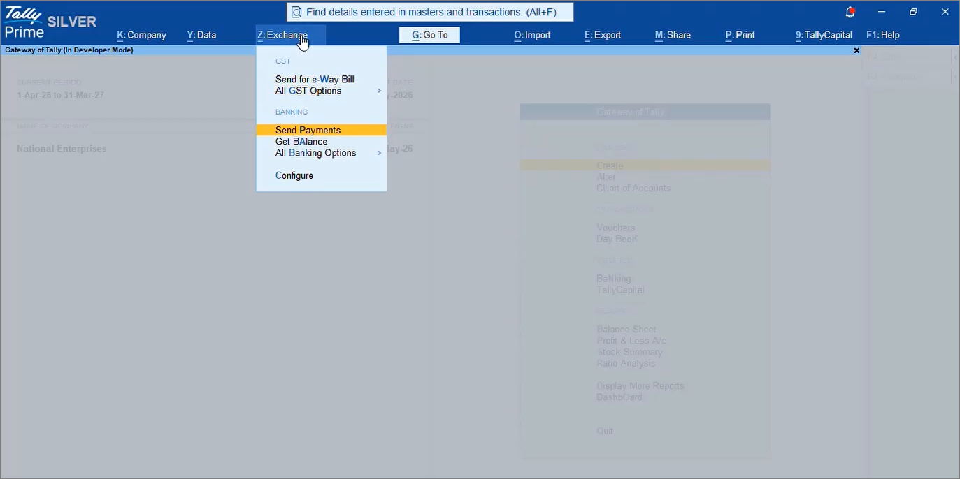

  1. From anywhere in TallyPrime, press Alt+Z (Exchange) > Send Payments.
    Send Payments in TallyPrime
  2. Select the transaction and press S (Send).
    Send Payments from ICICI Bank Account Using Connected Banking in TallyPrime

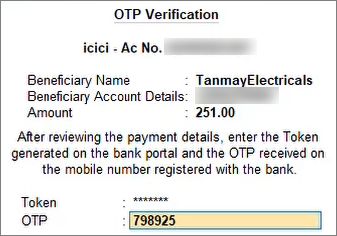

    1. Enter the Token generated on the ICICI Bank portal.
    2. Enter the OTP received on your mobile number.
      OTP for Online Payments from ICICI Bank Account Using Connected Banking in TallyPrime

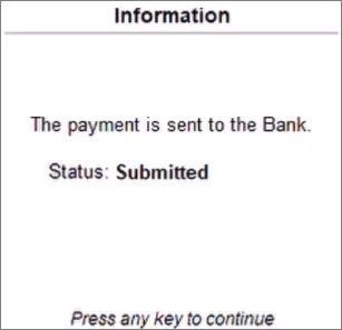

      The payment gets sent successfully.
      Online Payments Using Connected Banking Successful in TallyPrime for ICICI Bank Accounts
      If you enter wrong token or OTP, then with each attempt, a new OTP will be generated.
Once the payment is initiated, the actual payment status gets displayed, as per the bank. You can always update the Payment Status from the e-Payments report.

  1. While making an online payment, I entered an incorrect Token. How do I proceed?
    If you have entered an incorrect Token accidentally, then you can initiate the payment again and enter the correct Token. You will receive a new OTP. Once you enter it, you will be able to make the online payment.
    However, if the Token has expired, then you need to log in to the ICICI Bank portal and generate a new Token, which you can use to send payments using Connected Banking.

  3. I have sent the payment, and it’s successful. However, the status is still In Progress. How do I know the actual status?
    To update the payment status in the e-Payments report, press F10 (Get Online Payment Status).
    You will get to know the latest status, as on the bank portal.
