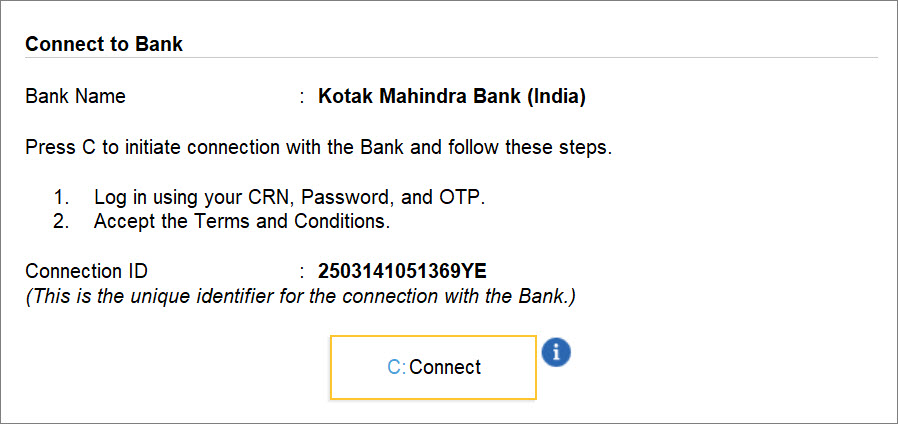

  3. Select Kotak Mahindra Bank.
    A connection ID gets generated.
  4. Press C (Connect) in the Connect to Bank screen.
    Consequently, you get redirected to the bank portal.
