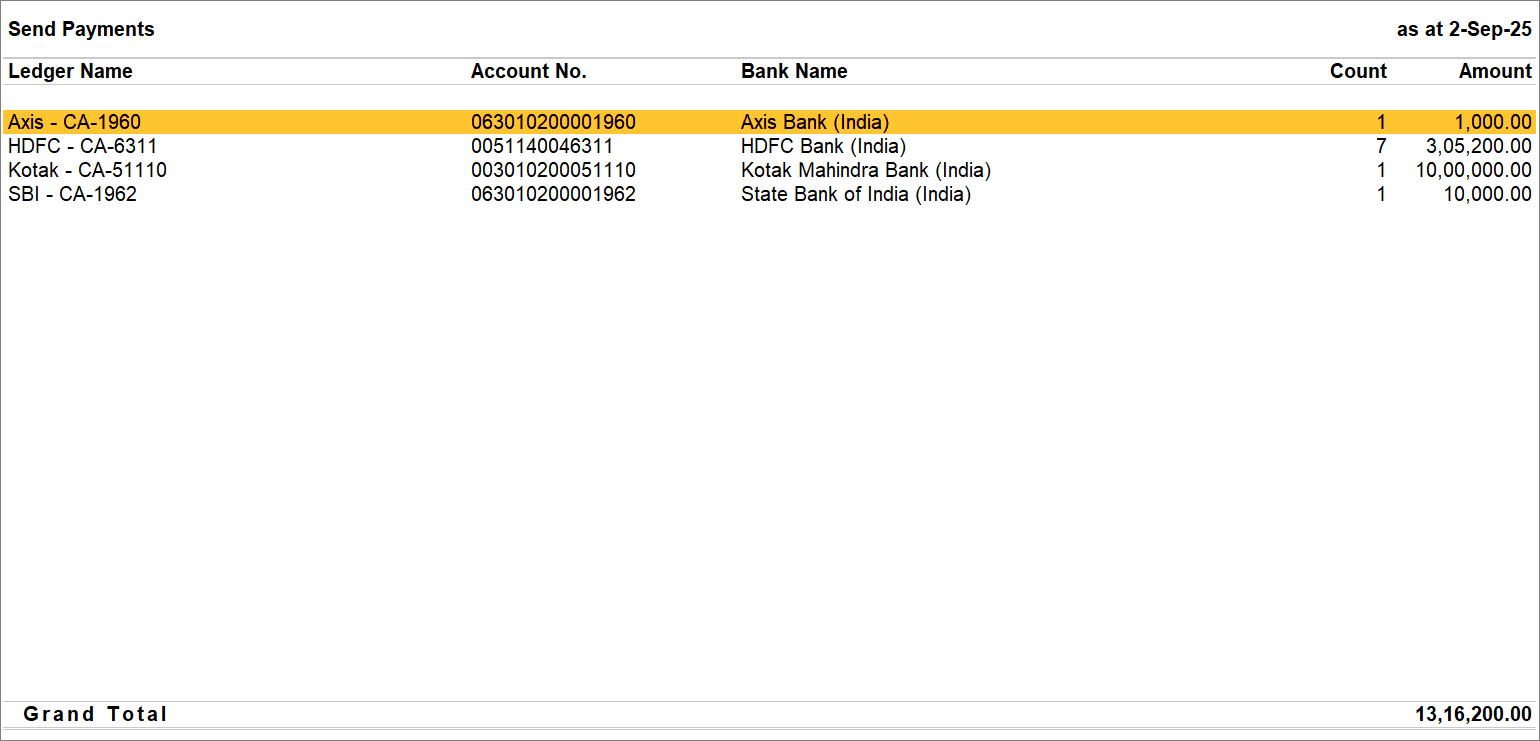

  1. From anywhere in TallyPrime, press Alt+Z (Exchange) > Send Payments.
  2. Press Enter on the relevant bank ledger.

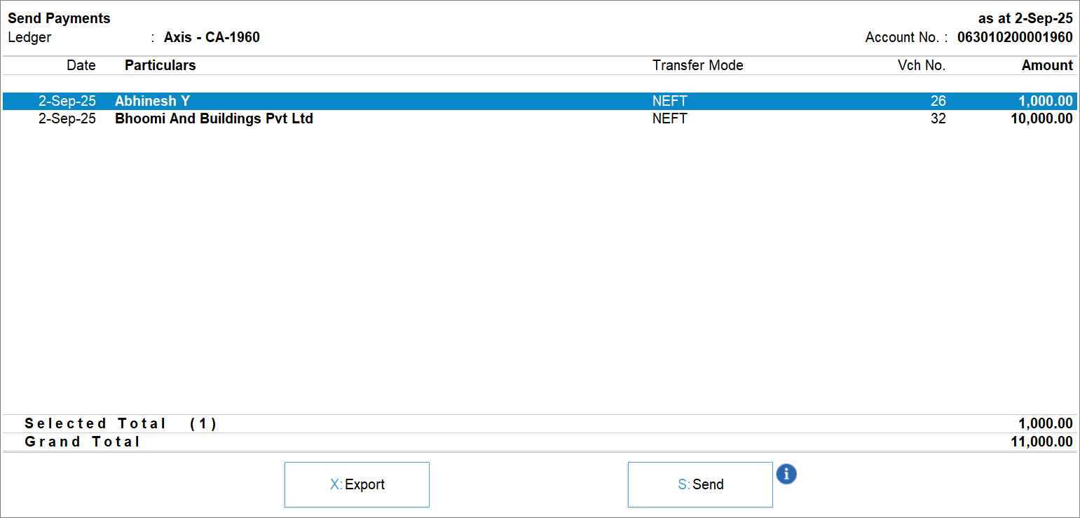

    From the e-Payments report in Banking Activities, if you open the Send Payment report for a specific bank ledger, then the report opens for that bank ledger.
  3. Press Space bar to select the transaction and press S (Send).

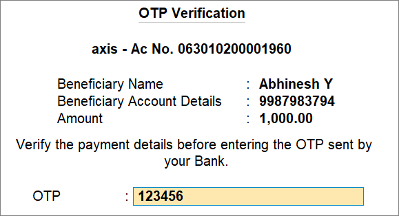

  4. Enter the OTP.
    OTP Verification
    The OTP needs to be entered either in TallyPrime or on the Bank portal after redirection, based on the Bank policy.
    Once you enter the OTP, the payment is sent to the recipient.
