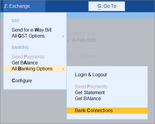

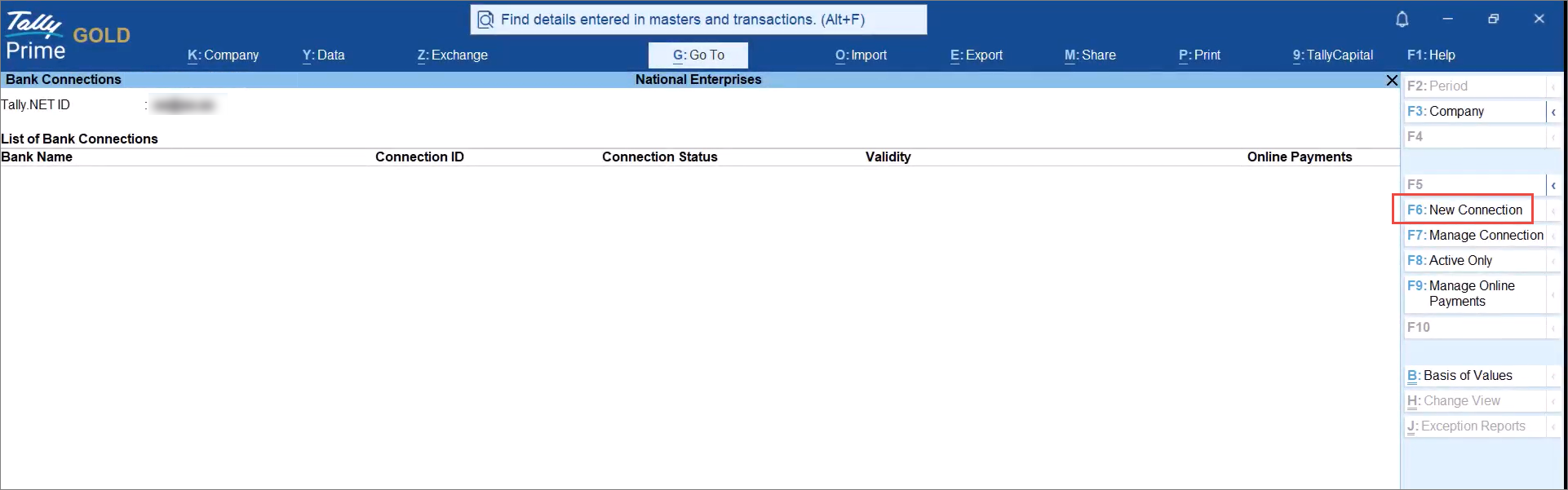

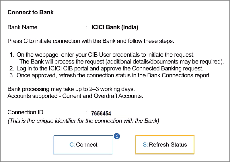

- In TallyPrime, press Alt+Z (Exchange) > All Banking Options > Bank Connections.
You need to log in to Connected Banking, if you haven’t already. - Press F6 (New Connection).
- Select ICICI Bank (India).
A Connection ID gets generated. - In the Connect to Bank screen, press C (Connect).
You will then be redirected to Tally’s ICICI Connection webpage on your browser.

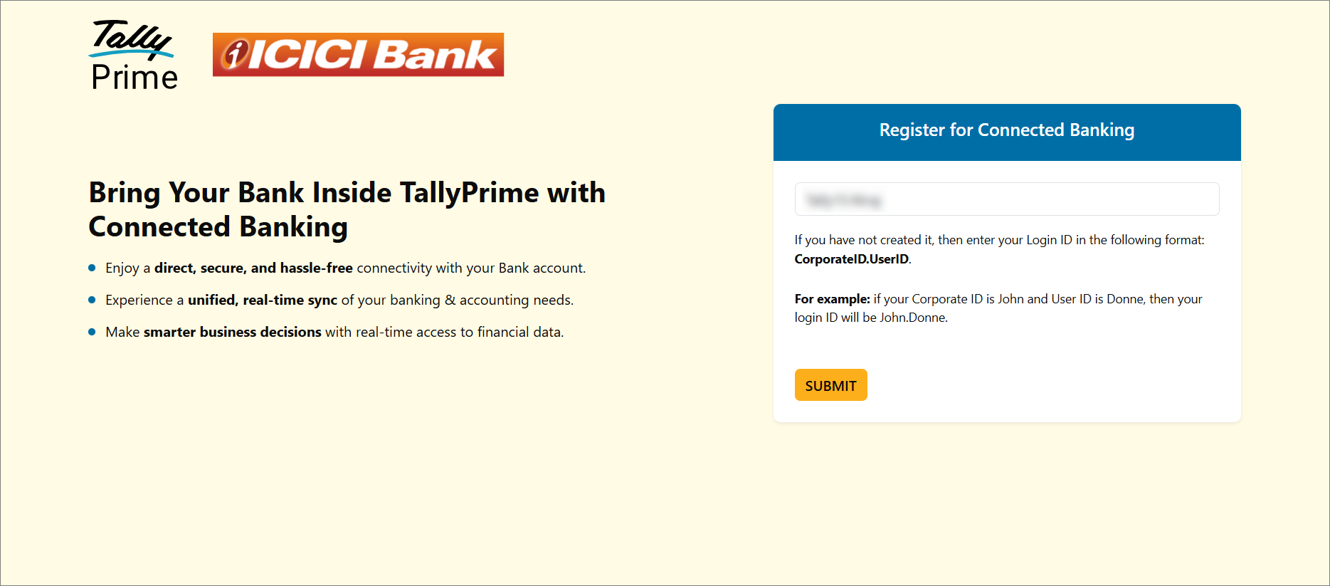

Submit Connection Request on Tally’s ICICI Connection webpage

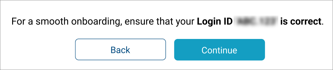

- Enter your CIB Portal Login ID.
If you have not created it, use the format: CorporateID.UserID. - Click SUBMIT.

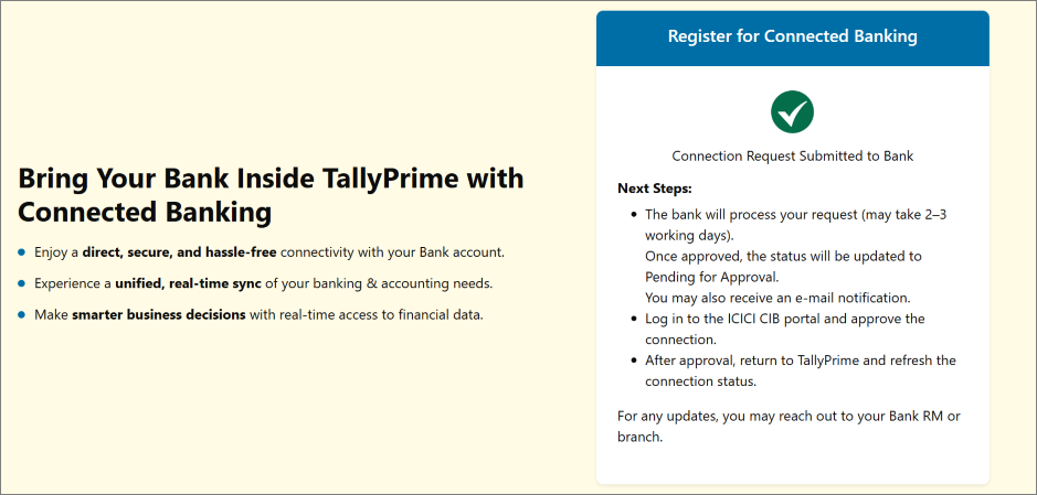

- Click Continue.
The connection request gets submitted.
At this point, the status of the ICICI Bank Connection in TallyPrime changes to In Progress.
After due diligence, your Bank Relationship Manager must approve this request. The RM might reach out to you for any further details. Once the request is approved, you will also receive an e-mail confirmation.
The approval request may take 2-3 working days to appear on the CIB portal.

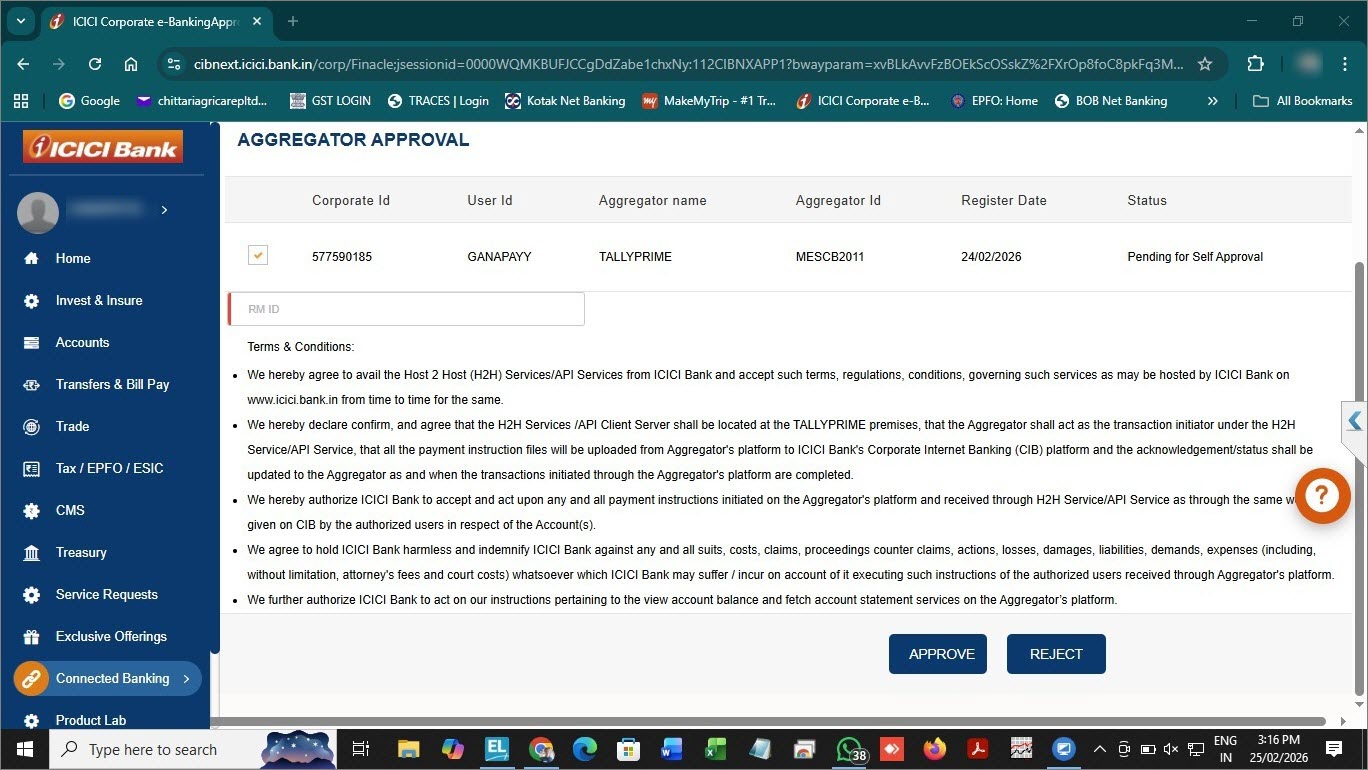

Approve the Connection Request on the CIB Portal

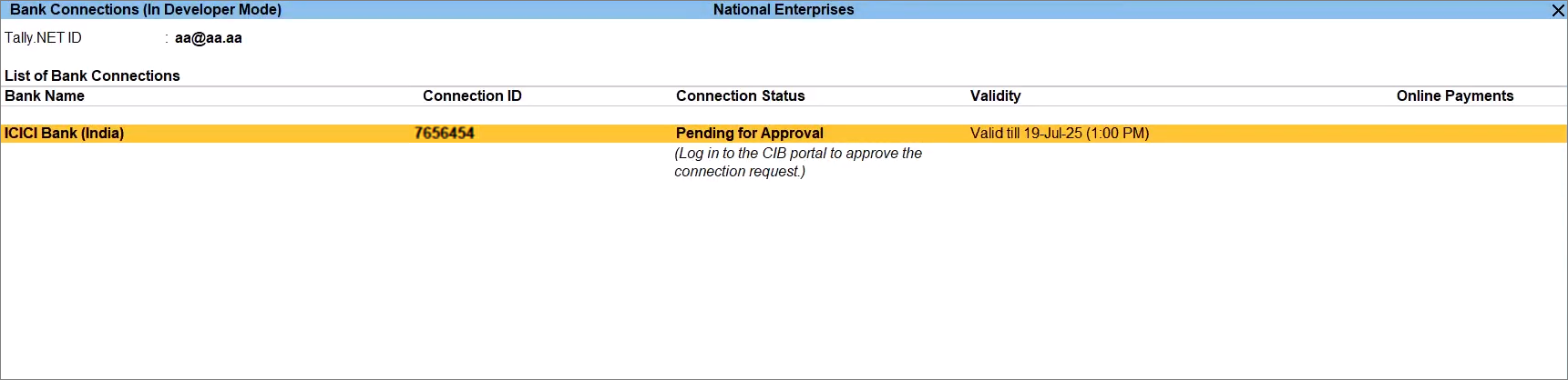

After the bank approves it, the Connection Status in the Bank Connections report changes from In Progress to Pending for Approval.
You need to approve this request on the ICICI CIB portal.

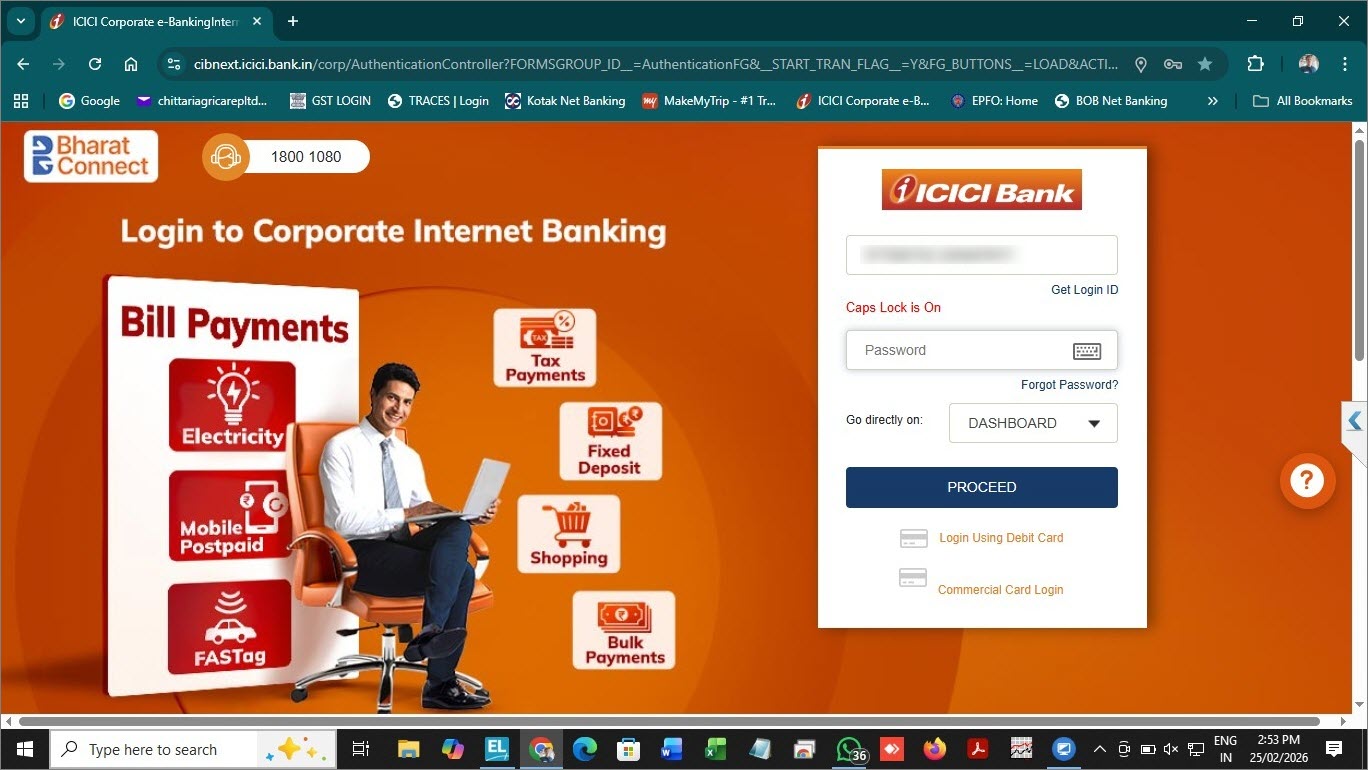

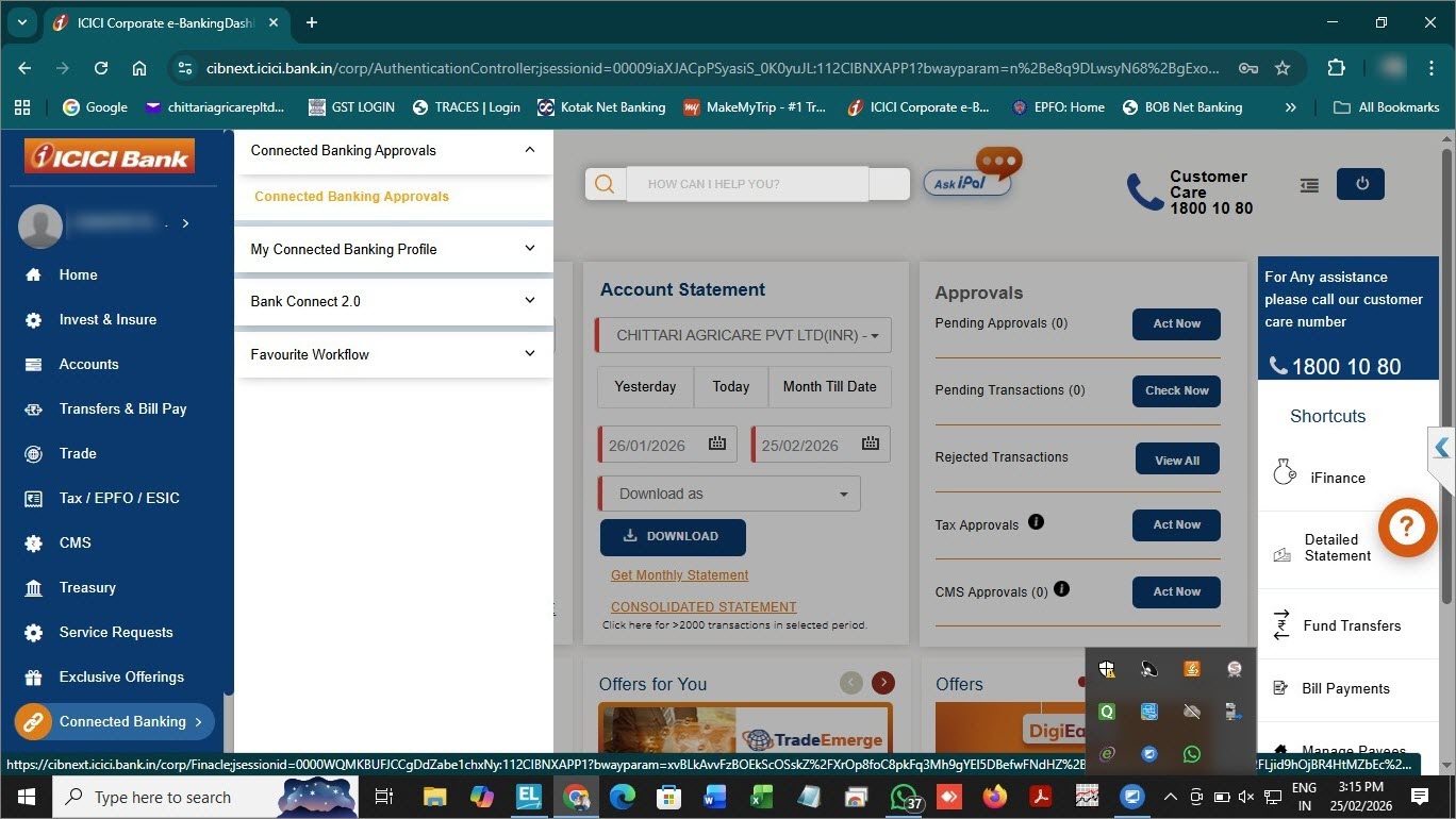

- Log in to the ICICI CIB portal.

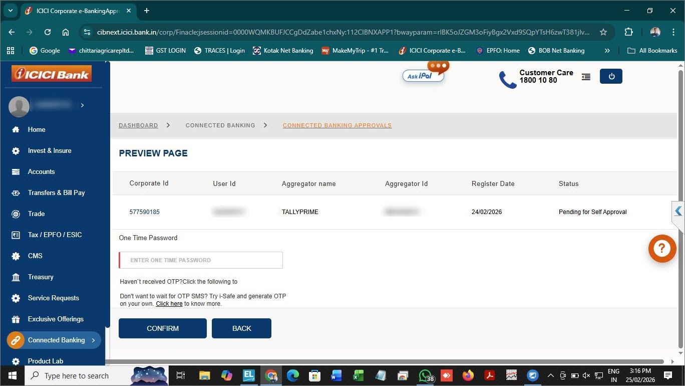

- Under Connected Banking, click Connected Banking Approvals.
- Initiate the approval of the relevant Connection Request.
- Confirm the Connection Request approval.

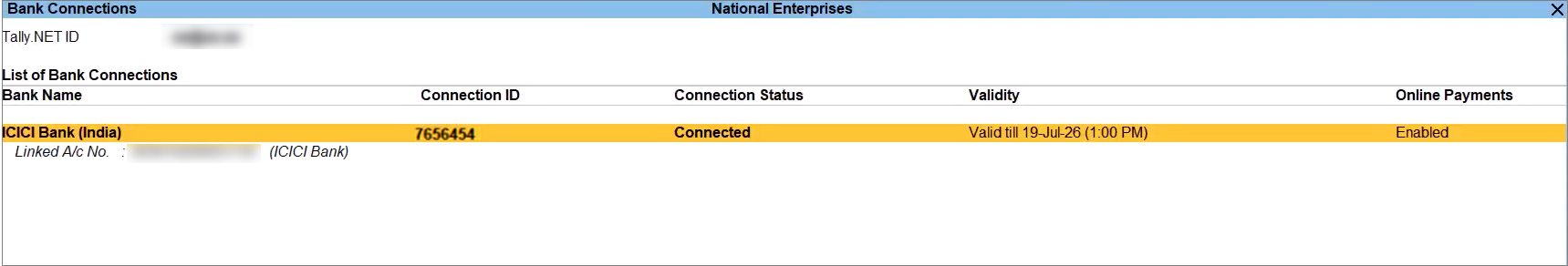

However, the account number will appear only after you get the bank account balance right from TallyPrime.
After getting the bank balance, return to the Bank Connections report.
The Account Number gets displayed.

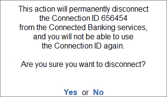

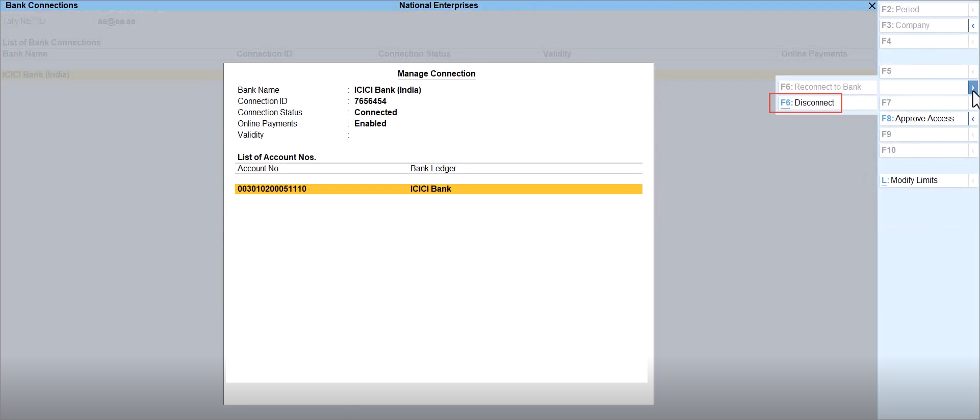

- Select the connection and press Enter, or press F7 (Manage Connection).

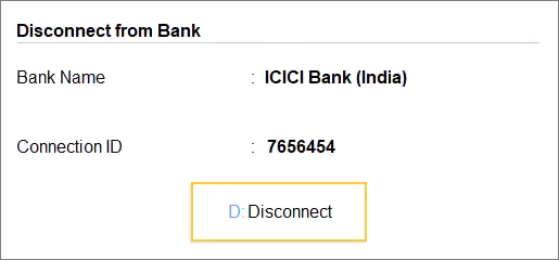

- In the Manage Connection screen, press Alt+F6 (Disconnect).
- In the Disconnect from Bank screen, press D (Disconnect).
- Press Y to confirm.
The ICICI Bank account gets disconnected from TallyPrime.

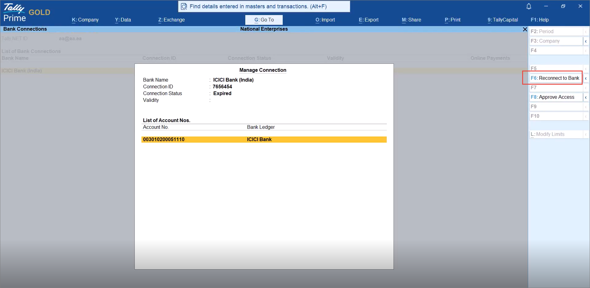

Reconnect Your ICICI Bank Accounts

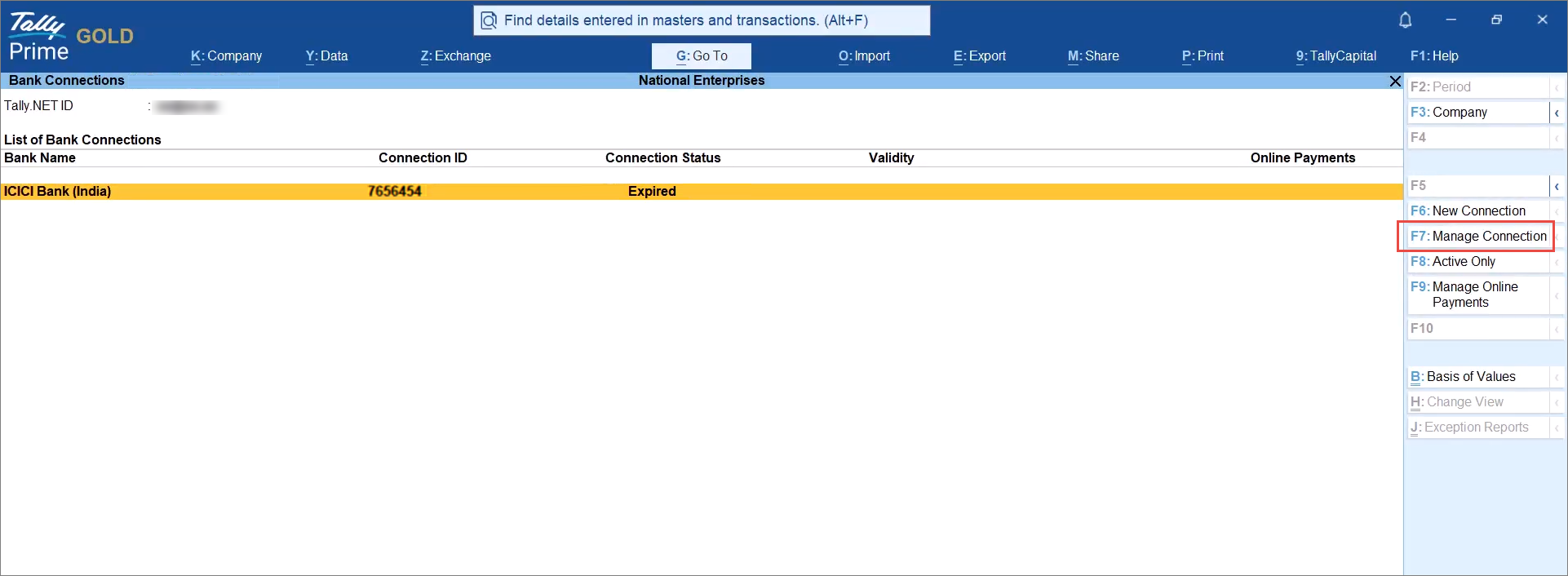

You can reconnect to the bank using an existing Connection ID when the Bank Connection gets expired, due to modification in your Tally.NET details, such as mobile number.

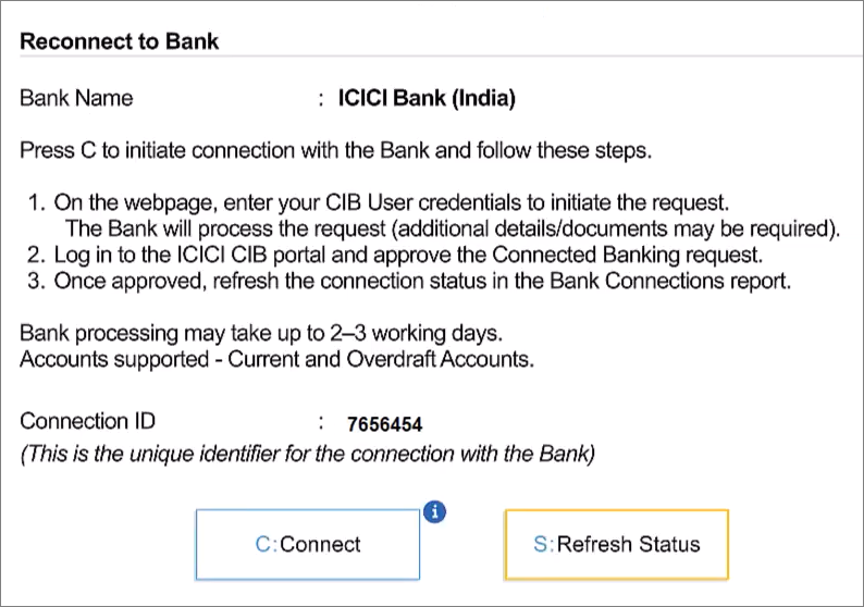

- In the Manage Connection screen, press F6 (Reconnect to Bank).
- In the Reconnect to Bank screen, press C (Connect).
You will be redirected to Tally’s ICICI Connection Portal.

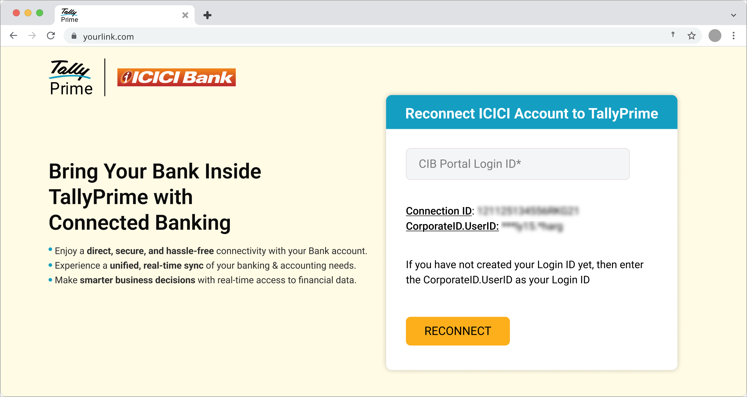

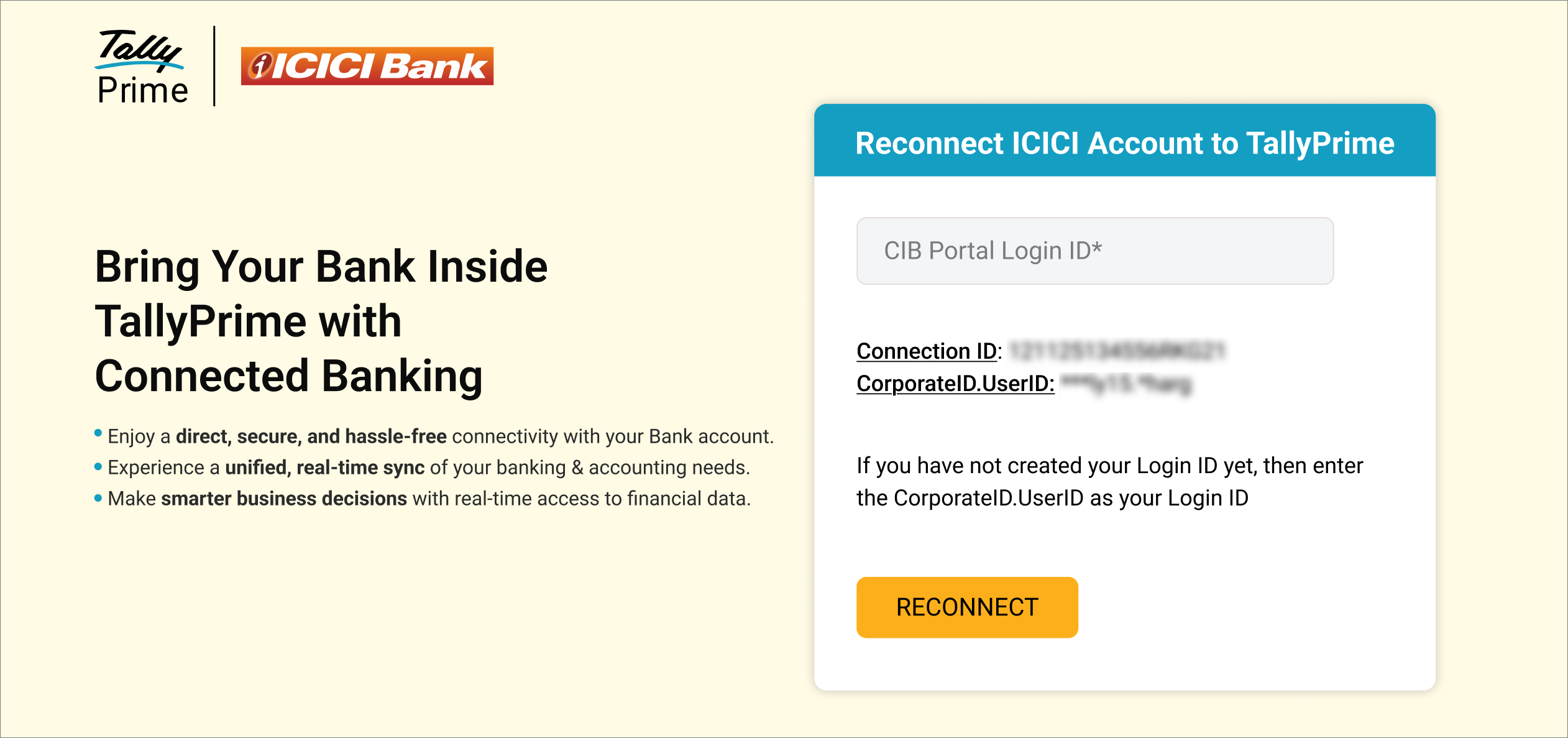

Submit the Connection Request on the Tally’s ICICI Connection webpage
You will see your Connection ID and Login ID displayed.
- On the webpage, enter your CIB Portal Login ID.
If you have not created it, use the format: CorporateID.UserID. - Click RECONNECT.
- Click Continue.

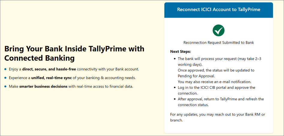

The reconnection request gets submitted to the bank.
Within 24 hours, the request starts appearing on the CIB portal.
You can then log in to the CIB portal and approve the request, just the way you would approve a connection request.

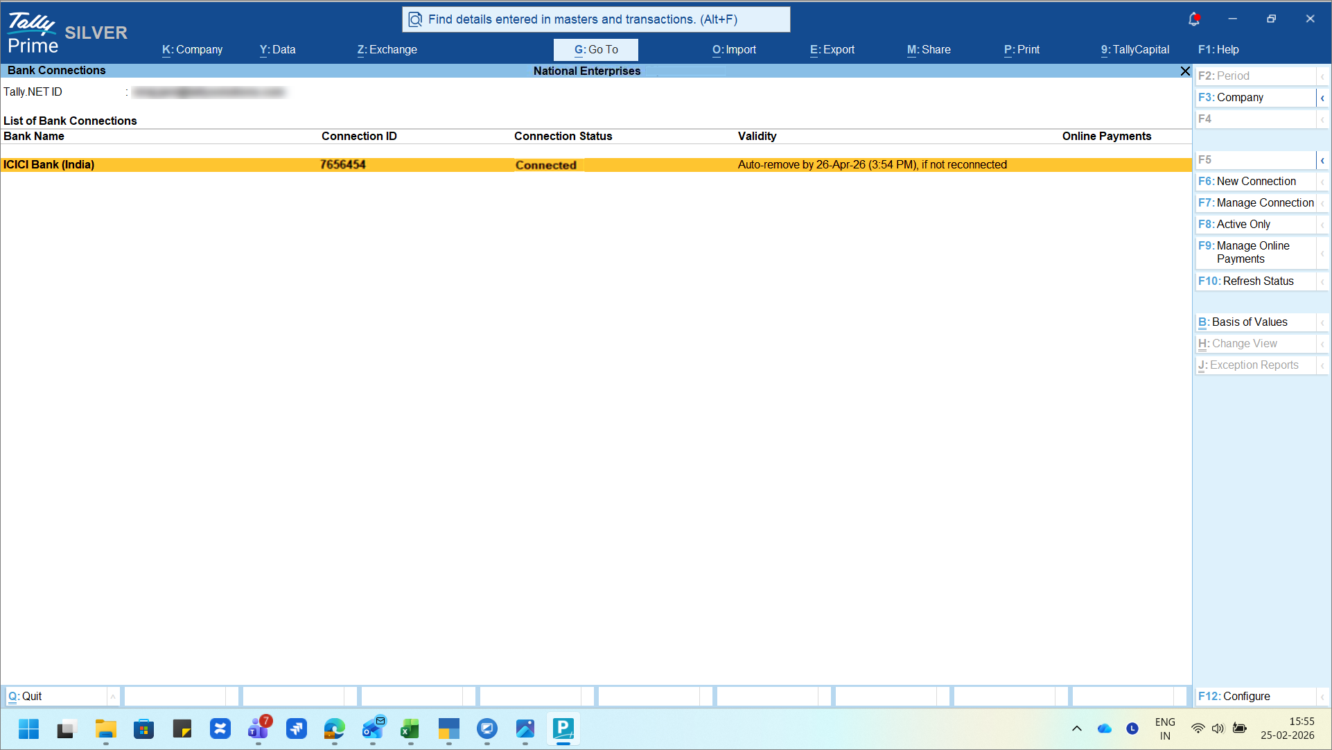

- Switch to TallyPrime.
- In the Bank Connections screen, press F10 (Refresh Status).
The Connection Status will appear as Connected, and the validity and linked account numbers will be displayed.
