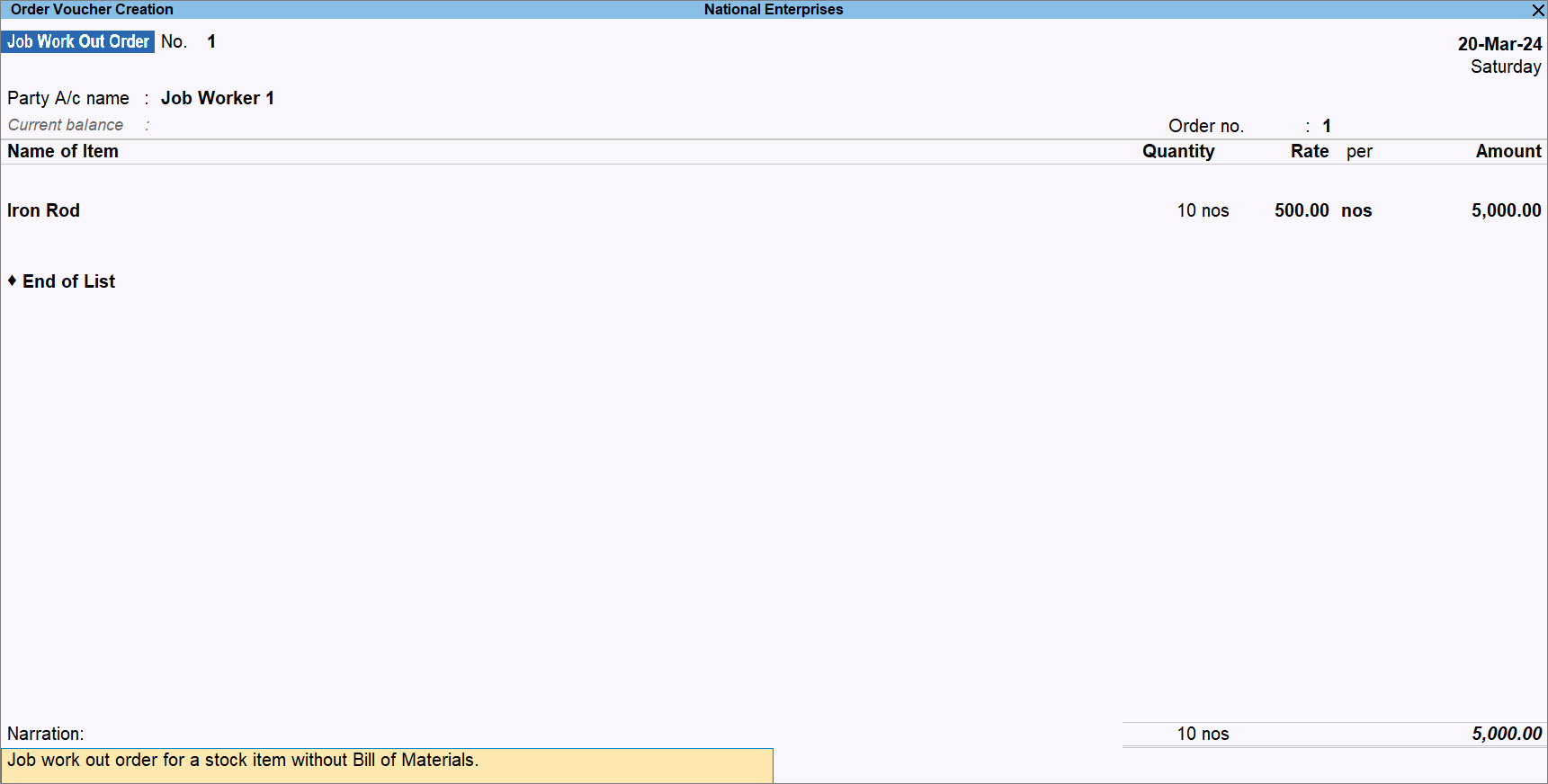

Record Job Work Out Order for Stock Items Without BoM
  1. Press Alt+G (Go To) > Create Voucher > press F10 (Other Vouchers) > type or select Job Work Out Order and press Enter.
  2. Party A/c name: Select the ledger created for the Job Worker, and press Enter.
  3. In the Dispatch Details screen, provide the process and dispatch details.
    1. Duration of Process: Enter the duration (number of days or weeks) required to complete the job work.
    2. Nature of Processing: Enter the nature of work to be done on the raw materials.
      For instance, when you send rods for painting, the nature of processing is application of paint on the rod.
      Note: In a Job Work Out Order, Duration of Process and Nature of Processing are optional. However, Nature of Processing must be specified when transferring goods to a job worker. If the transfer is recorded against the order, both details are captured automatically.
    3. Enter other necessary details, such as Dispatched through, Destination, Carrier Name/Agent, Bill of Lading/LR-RR No, and others.
      Dispatch Details for Job Work Out Order in TallyPrime
    4. Press Ctrl+A to save the dispatch details.
  4. Enter the Order No.
  5. Select the Stock Item.
  6. In the Stock Item Allocations screen, specify the details.
    1. Track Components: No, for an item without Bill of Materials.
    2. Due on: Enter the date of completion of the job work.
    3. Godown: Select the appropriate Godown.
    4. Quantity: Enter the quantity of the stock item.
    5. Enter the Rate, and the Amount gets calculated.
      Item Allocations for Job Work Out Order in TallyPrime
    6. Press Ctrl+A to save to save Item Allocations details.
  7. Enter other necessary details in the voucher and press Ctrl+A to save the voucher.
