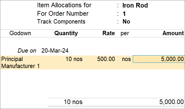

  6. Specify the Item Allocations.
    1. Track Components: No, for an item without Bill of Materials.
    2. Due on: Enter the date of completion of the job work.
    3. Godown: Select the appropriate Godown.
    4. Quantity: Enter the quantity of the stock item.
    5. Enter the Rate, and the Amount gets calculated.
      Item Allocations for Job Work In Orders in TallyPrime
    6. Press Ctrl+A to save to save Item Allocations details.

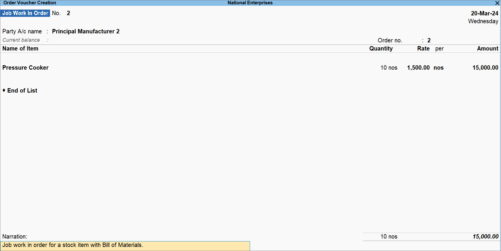

      Job Work in Order in TallyPrime
  7. Enter other necessary details in the voucher and press Ctrl+A to save the voucher.

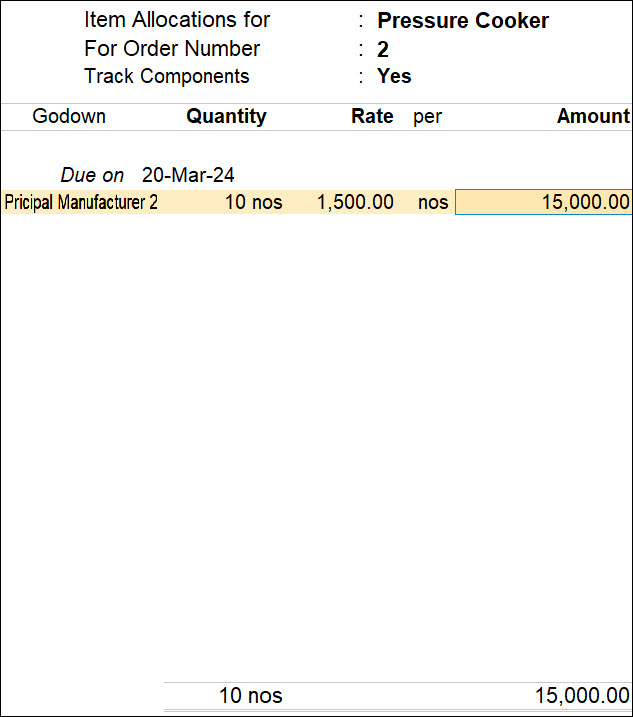

  1. Specify the Item Allocations.
    1. Track Components: Yes, for an item with Bill of Materials.
    5. In the Components Allocations screen, specify the details.
      1. Specify the Component Allocations for the stock item or validate the same based on the Bill of Materials.
        Component Allocations for Job Work In Voucher in TallyPrime
      2. Press Ctrl+A to save the Component Allocations details.
    6. In the Stock Item Allocations screen, enter the Rate, and the Amount gets calculated.
      Item Allocations While Recording Job Work In Voucher in TallyPrime
    7. Press Ctrl+A to save the Item Allocations details.
  2. Enter other necessary details in the voucher and press Ctrl+A to save the voucher.

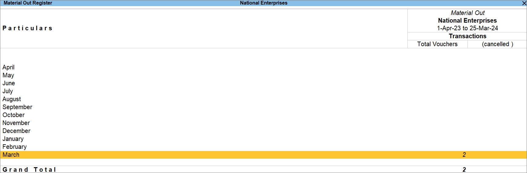

Once you record the Material Out Voucher, you can view the entry in the Material Out Register and check the Stock from principal manufacturer.

Once you record the Material Out voucher, you can view the entry in the Material Out Register report.
