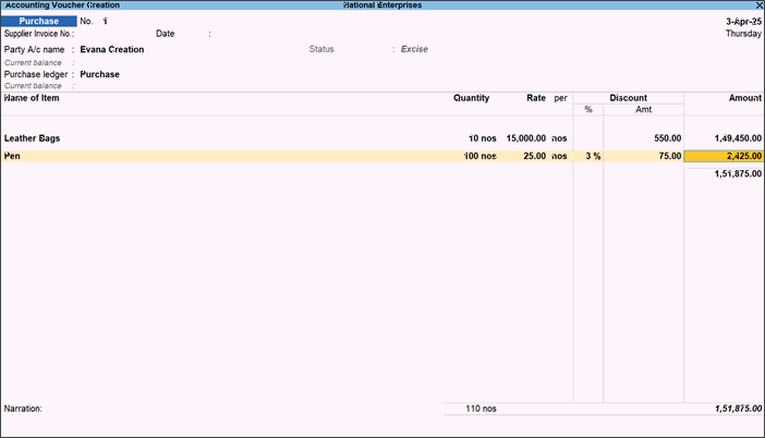

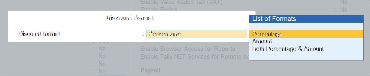

  1. Press F11 (Company Features) > set Use Discount column in invoices to Yes.
    If you do not see this option, set Show more features to Yes.
    Discount formats in TallyPrime
  2. In Discount format, select Percentage, Amount, or Both Percentage & Amount, as required.
  3. In the purchase invoice, after you have provided the Quantity and Rate, enter Discount % or Amt for the selected items.
    Apply discount in TallyPrime
  4. Enter the remaining details and accept the screen. As always, you can press Ctrl+A to save.
    The discounted item amount appears against each items.

You can enter the discount percentage against each item and the Amount will be calculated automatically.
  1. Press F11 (Features) > set Use Discount column in invoices to Yes.
    Henceforth, you will see the Disc % column in every purchase invoice.
    Item Wise Discount Feature in TallyPrime
  2. In the purchase invoice, after you have provided the Quantity and Rate, enter Disc % for the selected item.
    The Amount for the given quantity of the stock item is displayed after deducting the discount, without showing any change in the Rate.
    Discount on Each Item in TallyPrime
  3. Enter the remaining details and accept the screen. As always, you can press Ctrl+A to save.
    The discounted item amount appears against each item.
