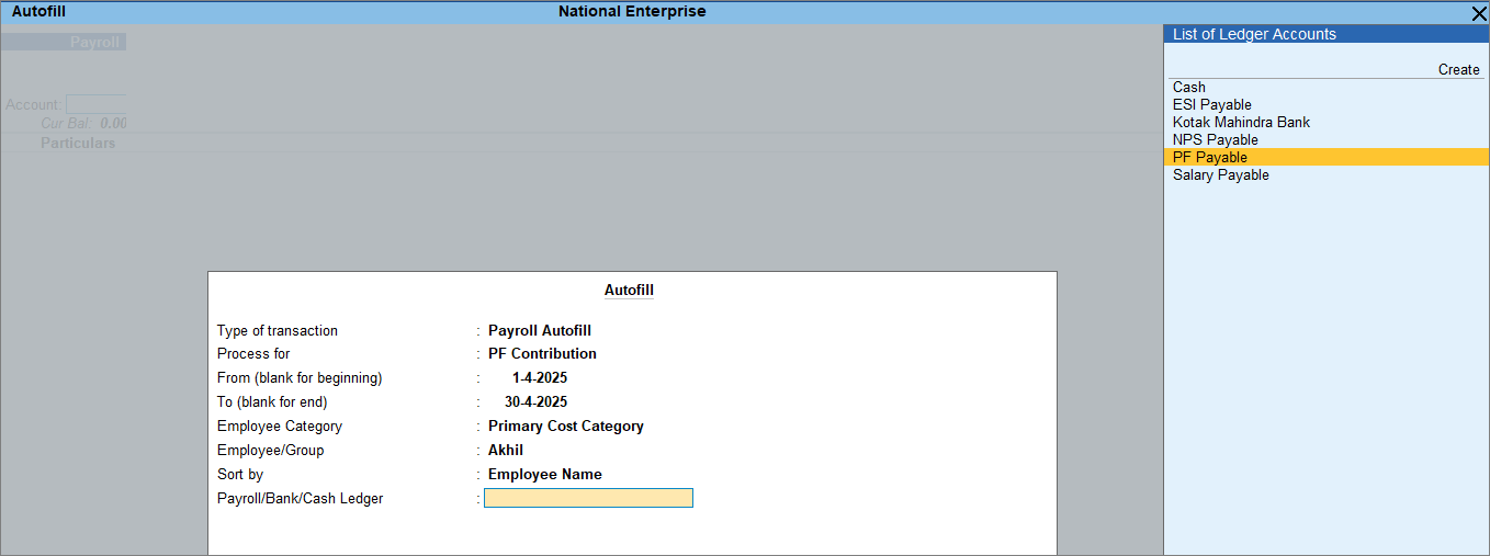

  1. Press Ctrl+F (Autofill) button.
    PF-Contribution
  2. In the Autofill screen, select the relevant option from the Process List.
    • PF Contribution
    • ESI Contribution
    • NPS Contribution
  3. Payroll/Bank/Cash Ledger: Select the required payable ledger from the List of Ledger Accounts.
    The amount is automatically calculated based on the formula defined while creating the pay head.

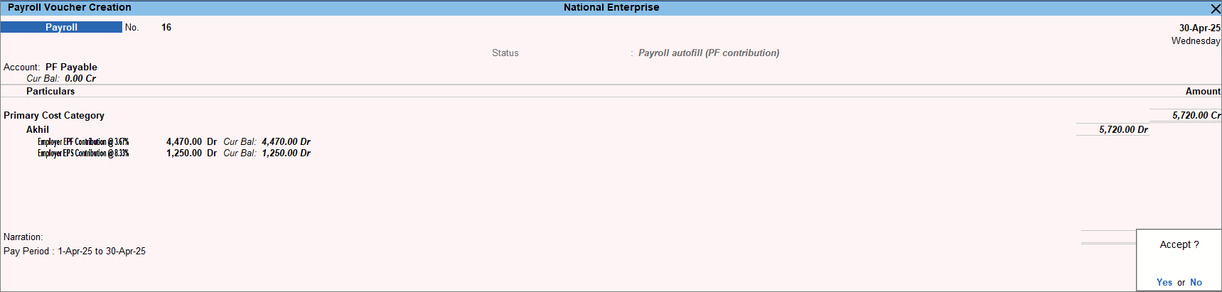

    PF-Contribution-Vch
  4. Press Ctrl+A to save the voucher.
Similarly, you can record the Employer’s Contribution for ESI and NPS.

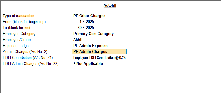

  2. Press Ctrl+F (Autofill) button.
    PF-Admin-charges-autofill
  3. In the Autofill screen, select Type of transaction as PF Other Charges.
  4. Enter the Statutory Ledger details.
    1. Expense Ledger: Select the ledger you have created to record PF Admin expenses.
    2. Admin Charges (A/c No. 2): Select the appropriate PF Admin Pay Head.
    3. EDLI Contribution (A/c No.21): Select the appropriate EDLI Contribution Pay Head.
    4. EDLI Admin Charges (A/c No.22): Select the appropriate EDLI Admin Charges.

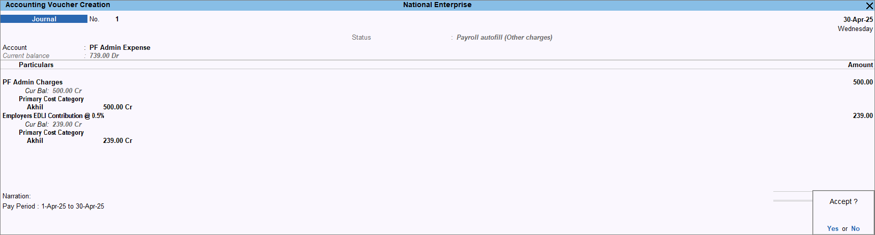

      PF-Admin-vch
  5. Press Ctrl+A to save the voucher.
