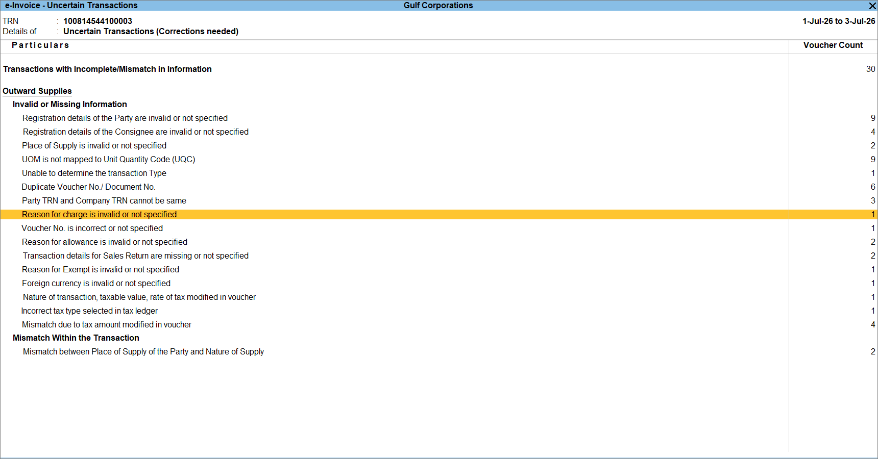

Reason for Charge is Invalid or not Specified
Cause
A charge ledger is used in the voucher without specifying the reason for the charge.
Resolution
  1. Drill down from the section.
    charge
  2. Select the required voucher.
  3. Set Provide VAT & e-Invoice details to Yes.
  4. In the Bill Details section, specify the Reason for additional charges.
  5. Press Ctrl+A to save the voucher.
