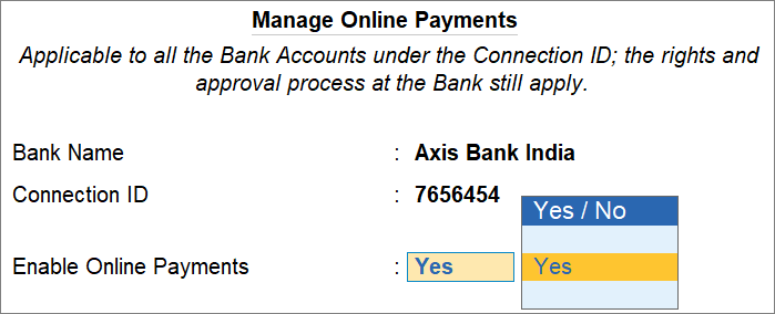

Enable Online Payments for Bank Connection
To start sending payments online using Connected Banking, you need to enable online payments for a specific Bank Connection.
Before you enable online payments, it is important to note the following:
  • Online payments can be enabled only by the user who initiated the Bank Connection.
  • Once you enable online payments:
    • Online payments get enabled for all the bank accounts under the Bank Connection.
    • All the users using the Bank Connection can send payments online using Connected Banking.
    • If the e-Payments in the Bank Ledger configurations is not enabled already, then it gets enabled when you enable online payments.
  • While you enable online payments in TallyPrime, the restriction, approval process, and regulations by the bank remain unchanged on the bank portal.

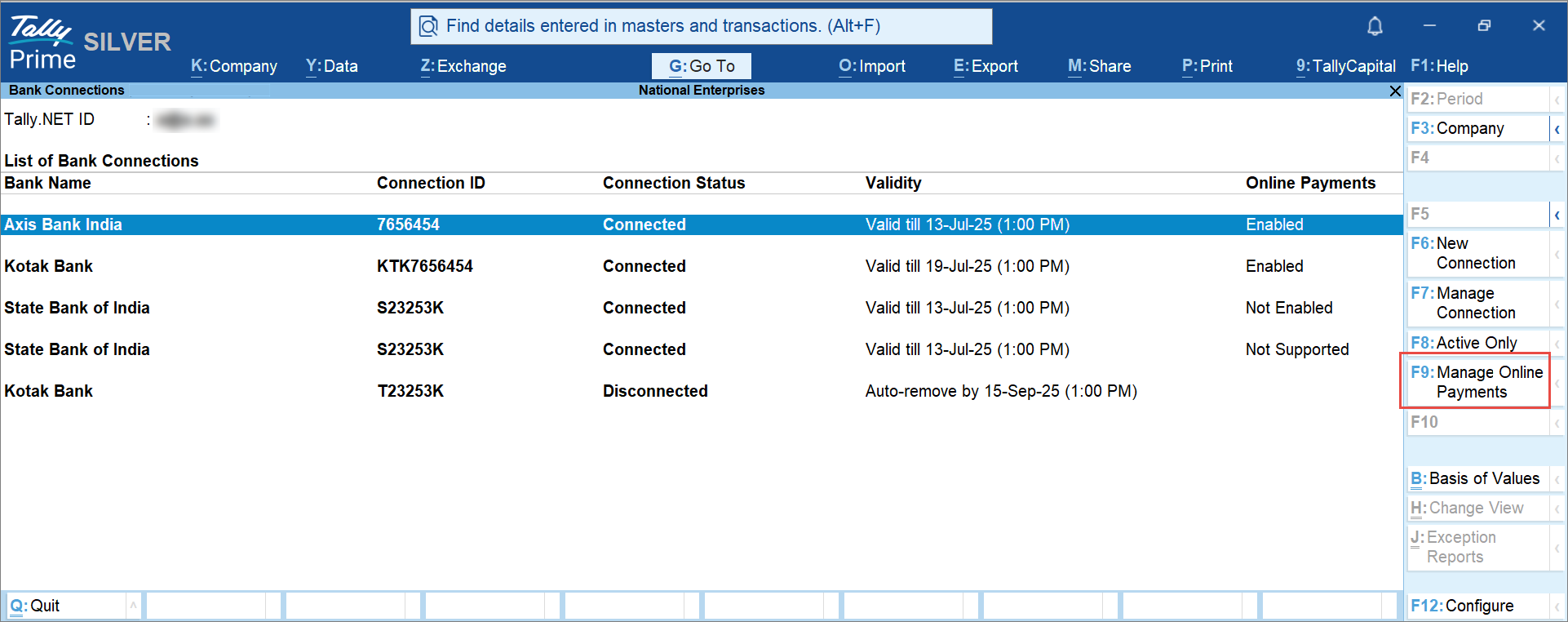

  1. Press Alt+Z (Exchange) > All Banking Options > Bank Connections, and select the Bank Connection.
  2. Press F9 (Manage Online Payments).
  3. Enable Online Payments: Yes.

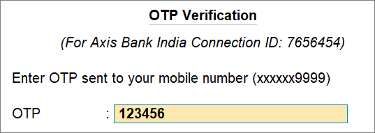

  4. Enter the OTP sent to your mobile number that is linked to your Tally.NET ID.
    The online payments get enabled.

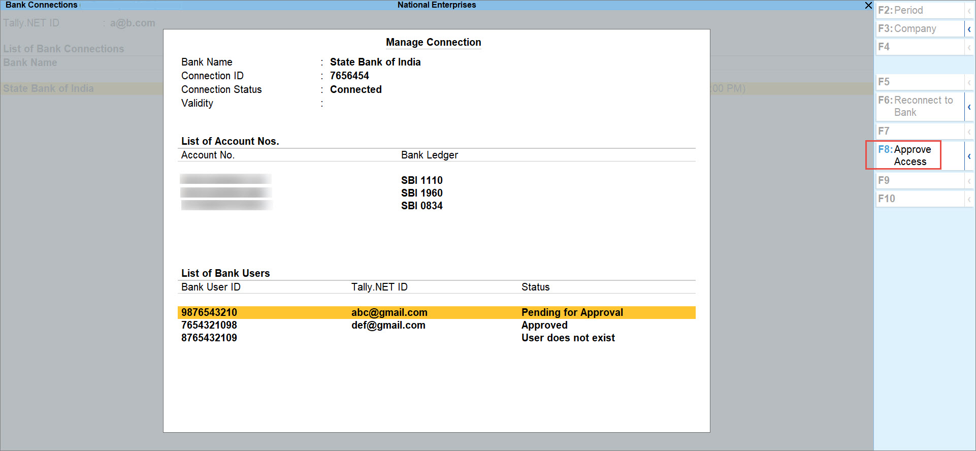

Manage User Access to Bank Accounts
If there are multiple users in a bank and your bank follows the system of approval, then you will see the list of users in the Manage Connection screen. You will need to approve user access to bank accounts.
However, in the list of users, a user might have the status as User does not exist when:
  • The user has not linked the mobile number.
  • The user does not have a Tally.NET ID.
Approve User
You can approve access for the users for whom approval is pending.
  1. In the Bank Connections report, press F7 (Manage Connection).
  2. Select the user, and press F8 (Approve Access).
    User Pending for Approval
  3. Press Y to confirm.
    The user will be able to access the Connected Banking services.

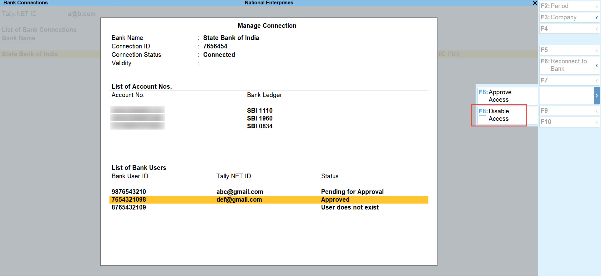

Disable User Access
If you want to disable bank access for a few users, then you can easily do so.
  2. Select the user and press Alt+F8 (Disable Access).
    Disable User Access to Connected Banking
    The user will no longer be able to access the Connected Banking services.
