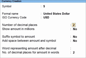

  1. Press Alt+G (Go To) > Create Master > Currency > and press Enter.
    Alternatively, Gateway of Tally > Create > Currency > and press Enter.
    The Currency Creation screen appears.
    When only the base currency is available, you will be prompted to create a new currency or alter the existing currency. Select Create or press C to create a new currency.
  2. Specify the currency details.
    1. Symbol: Enter the currency symbol.
      This symbol appears in your transactions.
    2. Formal name: Enter the name of the currency accepted globally.
      For example, enter US Dollars to distinguish different currencies having the same symbol.
      If you have two companies (ABC & XYZ) in TallyPrime, then you can set different currencies for both the companies. ABC uses symbol $ for Australian Dollars and XYZ uses the symbol $ for U.S. Dollars. The formal name distinguishes two different currencies with the same symbol, which helps when you compare the books of accounts for both the companies. The company that is loaded first retains the original symbol for display purposes. The other company’s currency symbol will be prefixed with the first letter/first few letters (to make it unique) of the formal name. Here, if ABC is loaded first then the symbol $ is for Australian Dollars and in XYZ (loaded next) the symbol $ is prefixed with the letter U (first letter of its formal name).
      You cannot assign a duplicate Formal name for a currency.
  3. Number of decimal places: Enter the number of decimal places, based on the practice you follow in your business.
  4. Set the option Show amounts in millions to Yes or No, as needed.
  5. Suffix symbol to amountYes
    This ensures that the symbol appears after the amount.
  6. Add space between amount and symbolYes.
  7. Specify details for the word representing amount after decimal.
    1. Enter the Word representing amount after decimal, for example, Paise.
    2. Enter the No. of decimal places for amounts in words.
      This number should be equal to or lesser than the number specified in Number of decimal places field.
      Create Currency in TallyPrime
  8. Accept the screen. As always, you can press Ctrl+A to save.

  3. Configure how the amount will be displayed with the currency in transactions and reports, if needed.
    1. Press F12 (Configure) > Provide Additional Base currency detailsYes and press Ctrl+A to save.
    2. Suffix symbol to amountYes, if needed.
      This will ensure that the symbol is added after the amount; for example, 200 ?.
    3. Add space between amount and symbolYes or No, as needed.
      A sample Company Alteration screen with the currency appears as shown below.
      Selecting the Base Currency for a Company in TallyPrime
  4. Accept the screen. As always, you can press Ctrl+A to save.

Alter currency
For a currency created in TallyPrime, you may have provided a SymbolFormal Name, or ISO Currency Code that is different than that used in the market.
You may also want to change the Number of decimal places, as per the system followed in your business.
In such cases, you can alter currency in TallyPrime.
In the Currency Alteration screen, follow the steps given below.
  1. Press Alt+G (Go To) > type or select Alter Master > type or select Currency. > select the currency you want to alter
    Alternatively, Gateway of Tally > Alter > type or select Currency. > select the currency you want to alter (here we are altering Base currency which is created during company creation)
    Please ensure that the Base Currency Symbol and Formal Name are identical across companies during data import/export or synchronization.
  2. If you are altering currency other than Base currency, you will additionally get Rates of Exchange section for alteration.
  3. Modify other details, if required.
