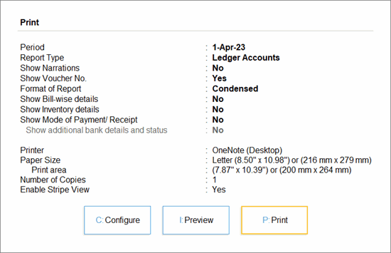

Print All Ledger Accounts
  1. Press Alt+P (Print) > Others.
  2. In the list of Multi Account Reports, select any report, say All Ledger Accounts > Enter.
  3. In the Print sub-screen, press C to configure the Multi-Account report, as needed.
    All ledger account configuration
    1. Change the report period to update the beginning and end date, if needed.
      Multi-account report configuration
    2. Enable Show Narrations, Show Bill-wise details, Show Inventory details, if needed.
  4. Press I (Preview), if needed, and press P (Print).
