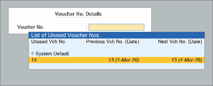

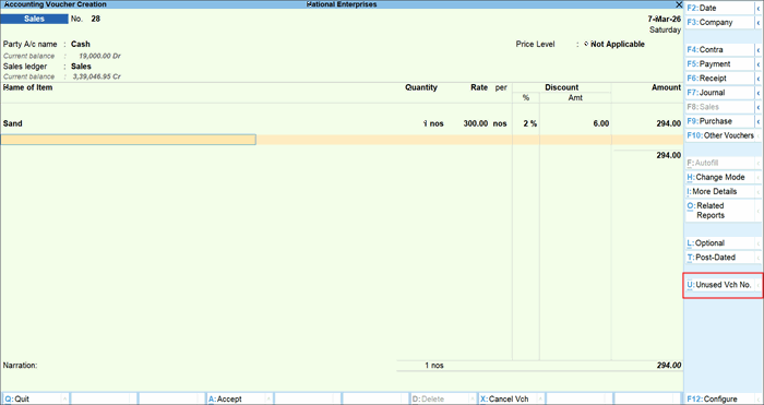

  3. Show unused voucher nos. in transactions for Retain Original Voucher No. behaviour: Yes to eliminate the gaps in your voucher numbering sequence if you had deleted any voucher earlier.
    1. Open the voucher where you want to apply the deleted voucher number.
      Use deleted voucher numbers in TallyPrime
    2. Press Ctrl+Alt+U (Unused Vch No.).
      Alternatively, press Ctrl+I (More Details) > Voucher No. Details > Select Unused Voucher Nos.
      Reuse deleted voucher numbers in TallyPrime
    3. Accept the screen. As always, you can press Ctrl+A to save.
      The unused voucher number will be applied for the voucher.

  1. Show unused voucher nos. in transactions for Retain Original Voucher No. behaviour: Yes to eliminate the gaps in your voucher numbering sequence if you had deleted any voucher earlier.
    When you delete transactions or mark them as optional, then the corresponding voucher numbers remains unused. Setting this option to Yes helps you to view such unused voucher numbers when you enter a new voucher and apply or reuse these numbers, if needed. However, this option is available only for Automatic and Multi-User Auto voucher numbering.
    For example, if you have vouchers recorded with voucher numbers 1023 to 1027, and you had to delete voucher numbers 1023 from your books, this number will be retained as unused.
    While recording a transaction, say a sales voucher:
    1. Press Ctrl+I (More Details) > Voucher No. Details > Select Unused Voucher Nos.
    2. From the List of Unused Voucher Nos., select the voucher number that you want to apply to the voucher, and press Enter.
      The voucher number 1023 gets applied to the sales voucher that you are recording.
    3. Press Ctrl+A to save.

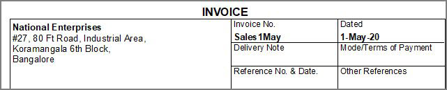

The sales voucher for the first voucher of May month appears, as shown below:
invoice-numbering
Restarting the numbering helps in maintaining clear and organized records, making it easier to track and analyze transactions within a specific time frame.
