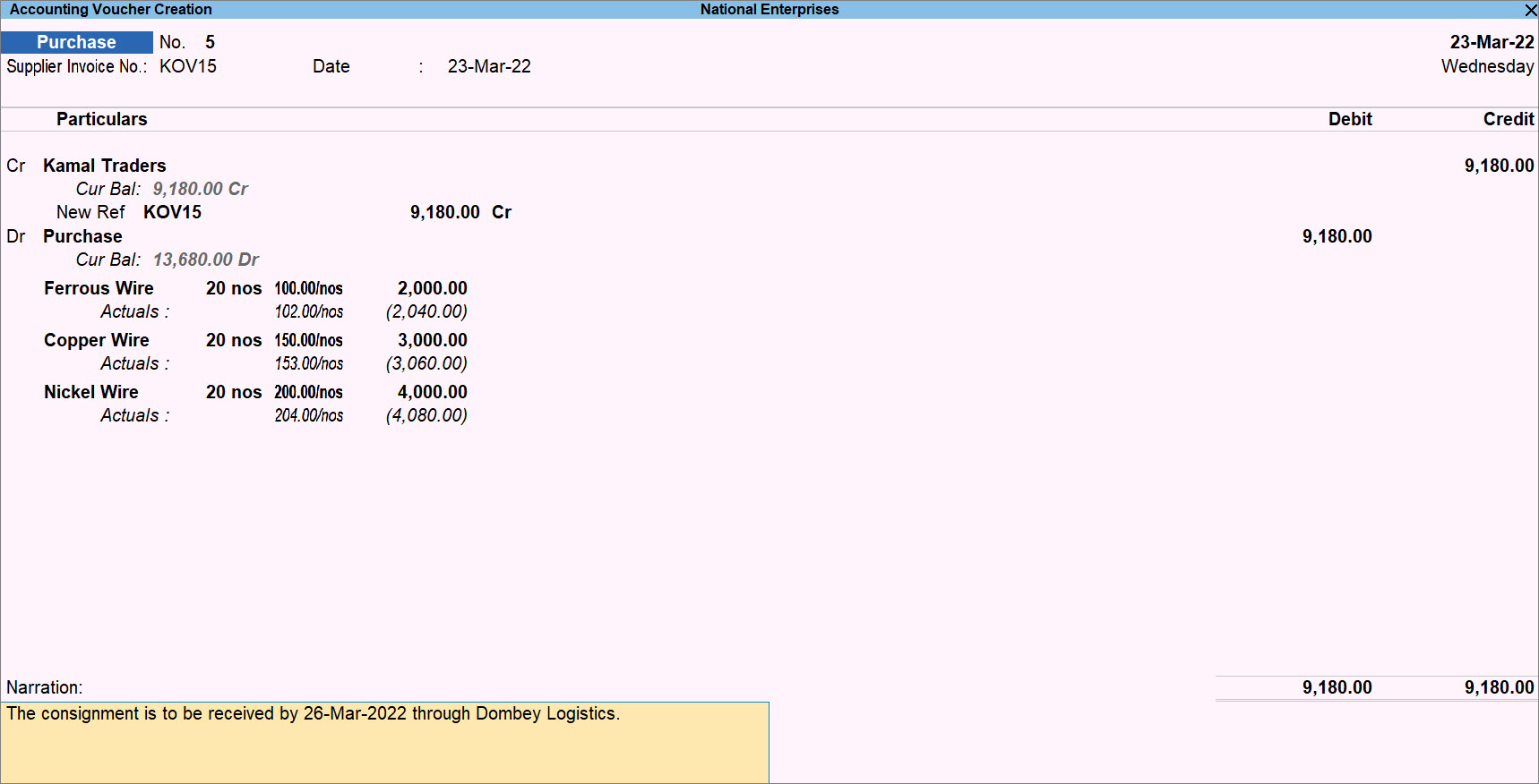

      Additional Cost for Stock Items in TallyPrime
    3. Select End of List, once you specify all the additional costs for the purchase of the stock item.
      The Inventory Allocations for: Purchase screen appears in which you can specify more stock items.
      Inventory Allocations for Ledger in TallyPrime
  7. Enter the Narration, if needed.
    Purchase Voucher To Track Additional Costs on Items in TallyPrime
  8. As always, press Ctrl+A to save.
