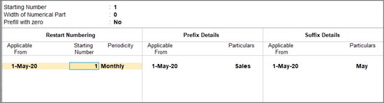

    1. Enter the abbreviation in the Abbreviation field, if required.

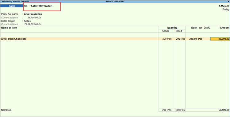

    2. Select the Method of voucher numbering from the Methods of Numbering list, which appears as shown below:
      To know more, refer to the Methods of voucher numbering section.

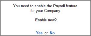

  2. Set the option Activate this Voucher Type to Yes/No to activate/deactivate the voucher type.
When trying to record a voucher, if it is inactive, you will get a prompt to enable the voucher type for your company.
Once enabled, you can record the voucher as usual in TallyPrime.

Restart voucher numbering
Restarting voucher numbering provides a way to reset and align the numbering system with organizational changes or financial periods for accurate financial record-keeping. You can restart the numbering of your vouchers by entering the date from which you want to restart the voucher numbers.
  1. Press Alt+G (Go To) > Create Master/Alter Master Voucher Type.
    Alternatively, Gateway of Tally > Create/Alter Voucher Type.
  2. Select the Method of Voucher Numbering.
  3. Prevent creating duplicate Voucher Nos.: Set this option to Yes, to ensure unique voucher numbers.
  4. Enable the option Set/Alter additional numbering details.
    The Voucher Type Creation (Secondary) screen opens.
  5. Enter the details as required.
    1. Starting Number: Enter the Starting Number as 1, if you want a fresh batch of voucher numbers from the date you created the company.
    2. Enter the Restart Numbering as required.If you want to restart the voucher numbering each month, enter the Starting Number and set the Periodicity
    3. Enter the Prefix Details and Suffix Details as required.
Now you can easily record your transactions with a new series of voucher numbers. The sales voucher appears as shown below:
Restarting the numbering helps in maintaining clear and organized records, making it easier to track and analyze transactions within a specific time frame.
