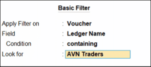

  1. In Day Book, press Ctrl+F (Apply Filter).
    In the Basic Filter screen, Apply Filter on is set to Voucher, by default.
  2. To Filter the vouchers based on a value/text used in any field, enter the text AVN Traders in the Look for field.
    TallyPrime will look for vouchers where AVN Traders has been used.
  3. Filter vouchers based on a value used in a specific field and set the parameters.
    1. Press F12 (Configure) and enable Select specific field to apply Filter.
    2. Select the Field, for example Ledger Name.
    3. Select the Condition, based on your need for filtering.
      For example:
      • Select containing if AVN Traders is only part of the party name.
      • Select equal to if the party name is AVN Traders.
  4. Press Enter to apply the filter.

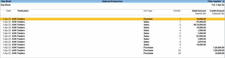

    Apply Basic Filter
    The Day Book with the Filter Applied status displays all the transactions with AVN Traders.
  5. To view the filter details with the fields that matched the filter conditions, press Ctrl+Alt+F (Filter Details).
