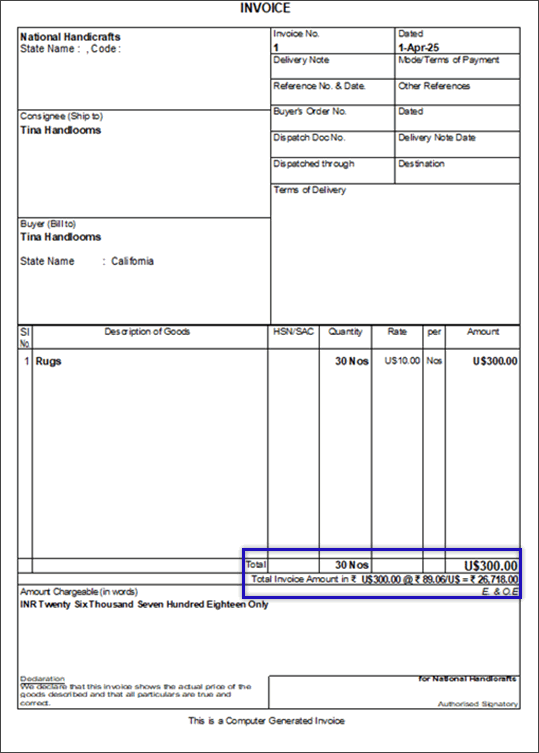

Print a Sales Invoice with Foreign Currency
  1. Open the sales voucher.
  2. Press Ctrl+P (Print) and press Enter on Current.
  3. Configure the print to include foreign currency.
    1. Press F12 (Configure) or press C.
    2. In the Print Configuration screen, locate Show Base & Foreign Currency for Total press Enter to enable it.
      Sales invoice print configuration for foreign currency in TallyPrime
    3. Press Ctrl+A to save the setting.
  4. Press I (Preview) to check the invoice before printing, if needed.
  5. Press P (Print) to print. The print preview of the sales invoice appears.
    Sales invoice in pdf format with foreign currency in TallyPrime
The Total Invoice Amount appears in both the base currency and the foreign currency.
