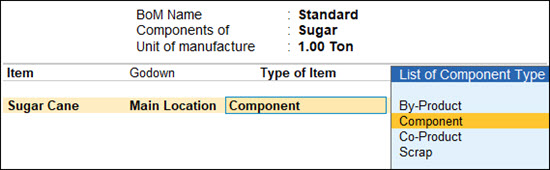

Single/multiple bill of materials with type of item
In TallyPrime, you can create Bills of Materials (BoMs) for manufacturing processes and account for co-products, by-products, or scrap as well.
For example, in the manufacturing process of sugar, you can create a BoM that includes the main ingredients consumed to produce sugar, along with any co-products such as molasses or by-products such as bagasse or scrap generated during the process. This allows for comprehensive tracking and management of all components involved in the manufacturing process.
  1. On Stock Item Components (BOM) screen, press F12 (Configure) > set Define Type of Component for BOM to Yes to define the type of components.
    On enabling this option, a new column Type of Item will appear in the Stock Item Components (BOM) screen.
  2. Specify the stock item components of the BOM with the type of item.
    1. Item: In this field the raw materials that are required to manufacture the finished goods.
    2. Type of Item: In this field select the appropriate type for the item selected.
      • By-Product: Select this classification for the stock items which are produced as By-Product of finished goods.
      • Component: Select this classification for the Raw materials /inputs which are used or consumed for the production of finished goods.
      • Co-Product: Select this classification for the stock items which are produced as Co-product of finished goods.
      • Scrap: Select this classification for the stock item produced as scrap in the process of manufacture of finished goods.
    3. Quantity: Mention the quantity of stock items required to manufacture the finished goods.
    4. Rate (%): In this field, you can specify the percentage of the cost of components to be considered to determine the cost of production of Co-products/By-Products/Scrap.
      If the Component Type selected is Co-product/By-Product or Scrap, the cursor will move to the Rate (%) column to define the percentage of cost of production of Co-product/By-Product or Scrap.
