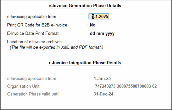

  1. Press F11 (Company Features) > e-Invoicing applicable: Yes.
    If you do not see this option, set Enable Value added Tax (VAT) to Yes and ensure all VAT-related details are filled in appropriately.
  2. Under e-Invoice Applicability,
    1. e-Invoicing applicable from: Enter the date on which the e-Invoicing will become effective.
    2. Print QR Code for B2B e-Invoice: Yes, to print QR Code in e-Invoice issued to other companies.
    3. E-Invoice Date Print Format: Specify a format for printing date on e-invoice.
    4. Location of e-Invoice archives: Specify the path/location where you want to save the e-Invoice in XML and PDF format.
      e-Invoice Applicability for Generation Phase
      If you have data related to Integration phase, you will also see the Integration Phase section displaying the details such as Application from Date, Serial number, and the date for Generation Phase validity.
    5. Press Ctrl+A to save the details.
