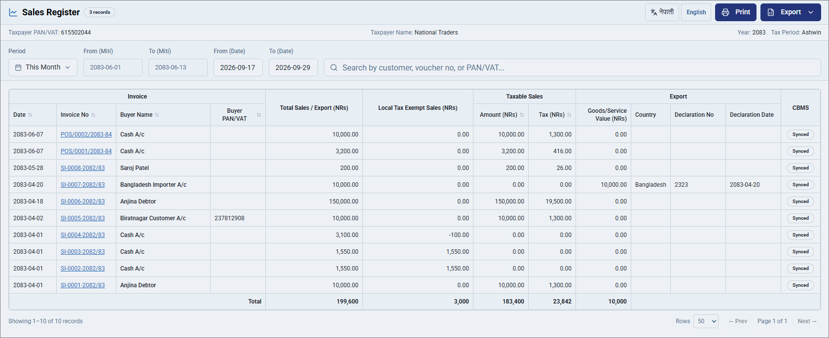

View Sales Register
The report displays details such as Buyer Name, Buyer PAN/VAT, Total Sales/Export, Taxable Sales, Export Details, and CBMS synchronisation status, along with other relevant information.
Ensure that:
- You have recorded Sales vouchers.
- From Gateway > click IRD Reports > then click IRD Registers > and then click Sales Register.
The report opens in Nepali by default.
- Click English to change the display language of the report.
- Select the required Period.
- Drill down from the Invoice No. to view the voucher details.
- To export the report, click Export and select Excel or PDF.
- Click Print to print the report.

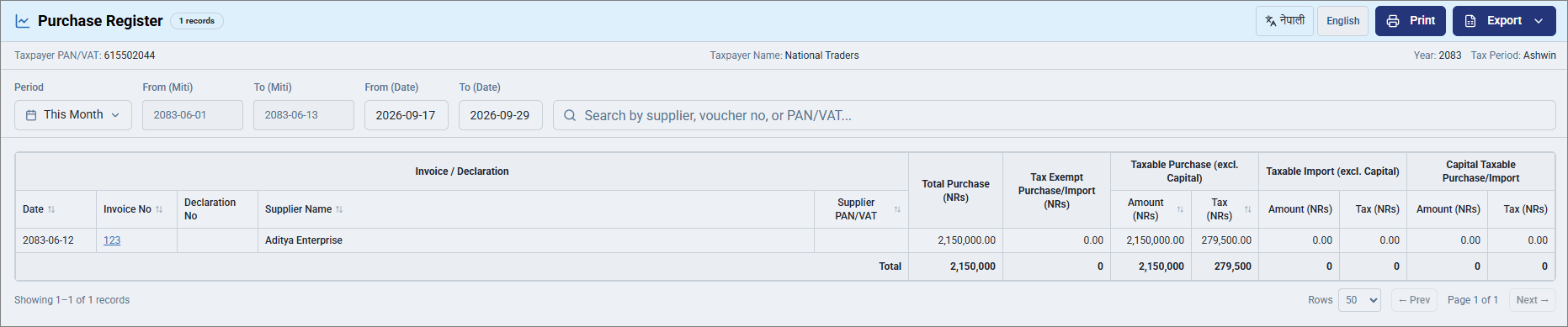

View Purchase Register
The report displays details such as Supplier Name, Supplier PAN/VAT, Total Purchase, Tax Exempt Purchase/Import, Capital Taxable Purchase/Import, along with other relevant information.
Ensure that:
- You have recorded Purchase vouchers.
- From Gateway > click IRD Reports > then click IRD Registers > and then click Purchase Register.

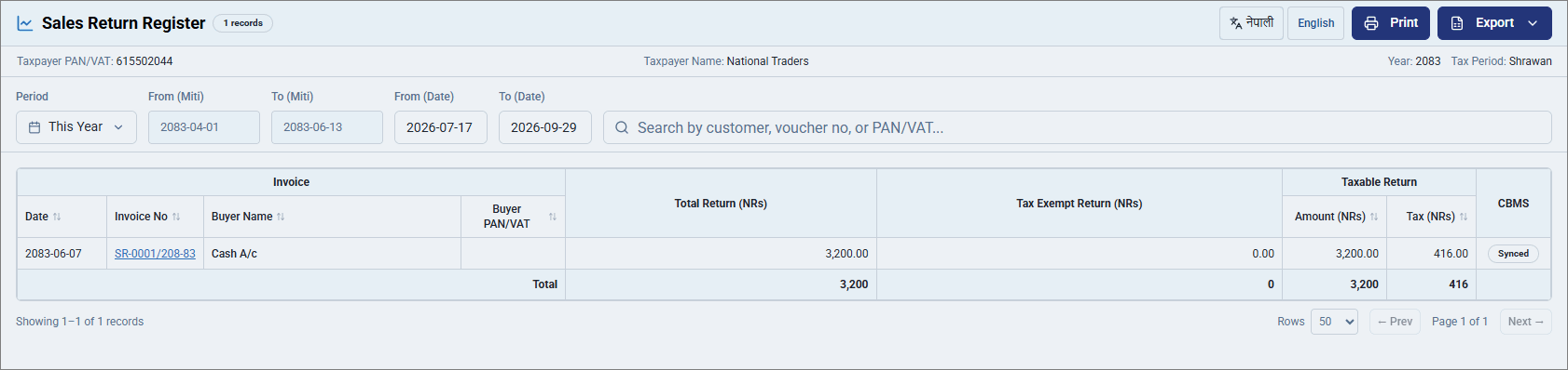

View Sales Return Register
The report displays details such as Buyer Name, Buyer PAN/VAT, Total Return, Tax Exempt Return, Taxable Return, and CBMS synchronisation status, along with other relevant information.
Ensure that:
- You have recorded Sales Return vouchers.
- From Gateway > click IRD Reports > then click IRD Registers > and then click Sales Return Register.

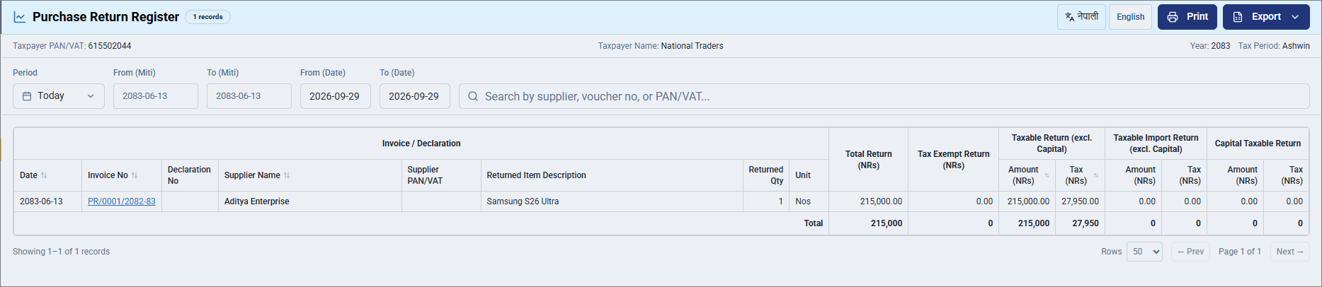

View Purchase Return Register
The report displays details such as Supplier Name, Supplier PAN/VAT, Returned Item Description, Returned Qty and Unit, Total Return, Tax Exempt Return, Capital Taxable Return, along with other relevant information.
Ensure that:
- You have recorded Purchase Return vouchers.
- From Gateway > click IRD Reports > then click IRD Registers > and then click Purchase Return Register.
