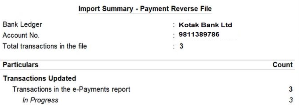

Based on the information in the payment instructions uploaded on the bank portal, the bank provides you with a payment reverse file that you can download from the portal itself.
When you import the payment reverse file in TallyPrime, the e-Payment statuses get updated based on the actual status of the payments on the bank portal. This helps you identify if any payments are yet to be processed or are unsuccessful.
If there are any unsuccessful payments, you can reset the e-Payment status and export the payment instructions with the correct details.
