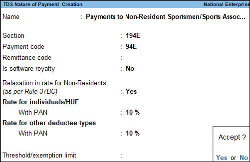

Configure Nature of Payment for Rule 37BC
In the TDS Nature of Payment screen:
- Press F12 (Configure) > enable Allow relaxation in rate for Non-Residents, and press Ctrl+A to save the configuration.
- Select the Section as 194E.
The Payment Code and Remittance Code will be filled automatically. - Set Relaxation in rate for Non-Residents (as per Rule 37BC) to Yes.
- Select the rate as 10%, With PAN for individuals/HUF and other deductee types.
- Enter the Threshold/exemption limit, if applicable.
- Press Ctrl+A to save.
Similarly, for non-eligible transactions, create another Nature of Payment with the same Section and Payment Code with Relaxation in rate for Non-Residents (as per Rule 37BC) set to No.
It is recommended to maintain separate Nature of Payment masters for Rule 37BC-eligible and non-eligible transactions.

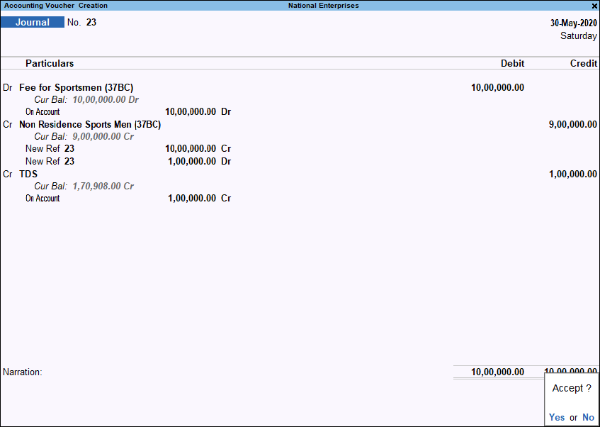

Record TDS under Rule 37BC
In the Journal voucher, select the Nature of Payment based on whether the non-resident party is eligible for Rule 37BC relaxation.
For an eligible party:
- Debit the TDS expense ledger and enter the amount.
- Credit the TDS party ledger eligible for Rule 37BC and enter the amount.
- Credit the TDS tax ledger.
- Select the Nature of Payment configured for Rule 37BC from the List of TDS Nature Of Pymt.
- Provide other necessary details, and press Ctrl+A to save the voucher.
For a non-resident party not eligible for Rule 37BC relaxation, after selecting the TDS tax ledger, select the Nature of Payment with the option Relaxation in rate for Non-Residents (as per Rule 37BC) to No. TDS is then deducted at the applicable default higher rate.
