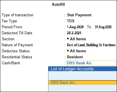

In the Payment voucher:
  1. Press Ctrl+F (Autofill) and select the Type of Transaction as Stat Payment.
  2. Select the Tax Type as TDS.
  3. Enter the Period From and To dates and provide the required details in the Statutory Payment screen.
  4. In Cash/Bank, select the bank or cash ledger.
    Autofill in TallyPrime
    The payment voucher is populated with the relevant values.

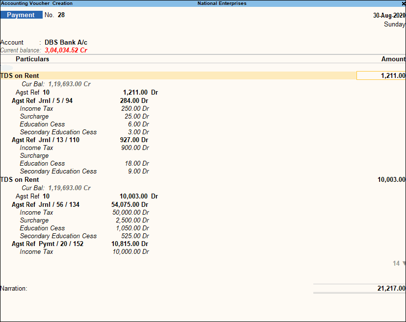

    Payment Voucher in TallyPrime
  5. Enter the required Bank Allocation details.
  6. Provide other necessary details, and press Ctrl+A to save the voucher.
The payment will be recorded.

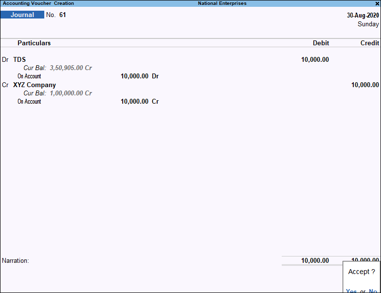

Record TDS Paid by Another Company
If another company pays the TDS to the government on your behalf, record the corresponding adjustment using a Journal voucher.
In the Journal voucher:
  1. Press F2 (Date) and enter the date of the payment.
  2. Debit the TDS tax ledger.
  3. Credit the company ledger that made the payment on your behalf.
    Journal Voucher in TallyPrime
  4. Provide other necessary details, and press Ctrl+A to save the voucher.

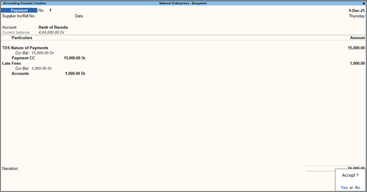

Record Late Fee for TDS
Record the late fee payable when a TDS return is filed after the due date.
  1. In Account, select the cash or bank ledger.
  2. Select the TDS tax ledgers and the relevant Nature of Payment.
  3. Select the ledger created for Late Fee grouped under Indirect Expenses.
  4. Select Late Fee from the list of Payment Types.
    Types of Payment in TallyPrime
  5. Enter the Amount on the payment voucher.
