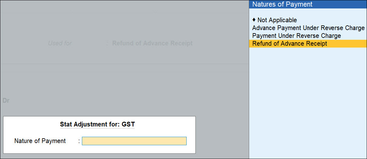

In the Payment voucher,
  1. Press Alt+J (Stat Adjustment) > select GST Nature of Receipt as Refund of Advance Receipt.
    Stat Adjustment in TallyPrime

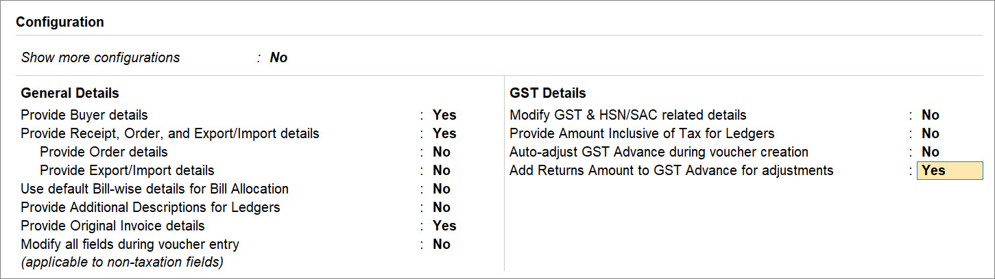

While recording a Credit Note,
  1. Press F12 (Configure) > enable the option Add Returns Amount to GST Advance for adjustments.

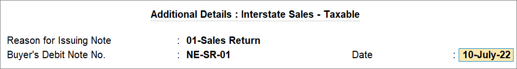

  3. Fill in the additional details for the sales return.
    1. Reason of Issuing Note: 01-Sales Return.
    2. Buyer’s Debit Note No.: Enter the debit note number
    3. Date: Enter the debit note date
      Credit Not Details in TallyPrime
    4. Press Ctrl+A to save the details.
