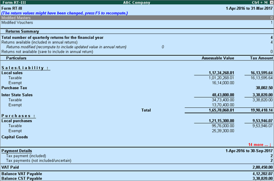

1.    Click F5: Recompute. The buttons F6: Overwrite and F7: Save as Revised appear once the return is recomputed.
For example, the Form RT-III appears as shown below:

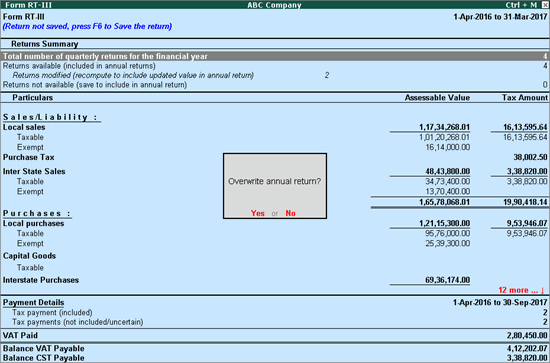

2.    Click F6: Overwrite to overwrite the existing return details with modified details. A confirmation message appears.
For example, the message in Form RT-III appears as shown below:
3.    Click Yes to overwrite the return.
