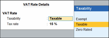

- Press F11 (Company Features) > e-Invoicing applicable: Yes.
If you do not see this option, set Enable Value added Tax (VAT) to Yes and ensure all VAT-related details are filled in appropriately. - Under e-Invoice Applicability,

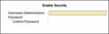

The Company must be security enabled. In case your company is not security enabled, it will prompt you to provide a username and password. Click here to know how to enable security for Company.
In the Company Alteration screen, the Disallow opening in Educational Mode field will be set to Yes to prevent any changes to e-Invoice transactions even in the Educational mode.
