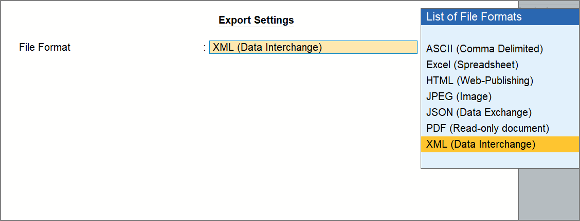

  3. Press C to configure the Export details as required.
    1. Set the Format of Report as Condensed or Detailed.
    2. Set the File Format as required from the List of File Formats.
      Form 26Q Export File Formats in TallyPrime
