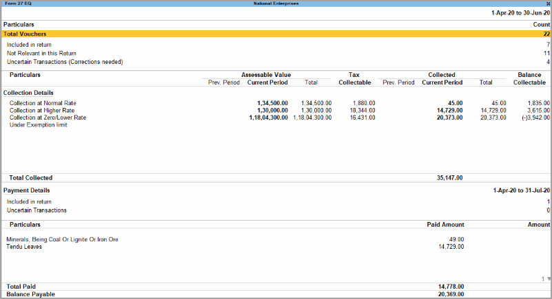

  1. Press Alt+G (Go To) > type or select Form 27EQ > and press Enter.
    Form 27EQ in TallyPrime
    The Total Vouchers section displays the transactions for the selected period under:
    • Included in return: Displays the vouchers that will form part of the return.
    • Not Relevant in this Return: Displays the vouchers that are excluded from the return.
    • Uncertain Transactions (Corrections needed): Displays the vouchers that are not included in the return because required information is missing or incorrect.
Drill down from the Total Vouchers section to view the Statistics report with the voucher types and their corresponding counts.

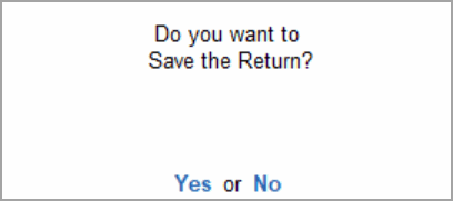

Save Form 27EQ
You can save the return after reviewing the exceptions. The steps differ depending on whether any Uncertain Transactions remain unresolved.
When there are no uncertain transactions
  1. Press Alt+B (Save Return).
    Save TCS Return in TallyPrime
  2. Select Yes to save the return.

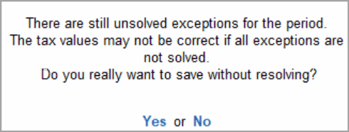

When there are unresolved uncertain transactions
  2. Select Yes to save the return without resolving the exceptions.

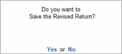

Save as Revised
You can save recomputed values as a revised return without overwriting the existing information.
  1. Press Alt+H (Save as Revised).
  2. Press Enter to accept and save the revised return.
Save as Revised is available only when the count of Uncertain Transactions is zero.

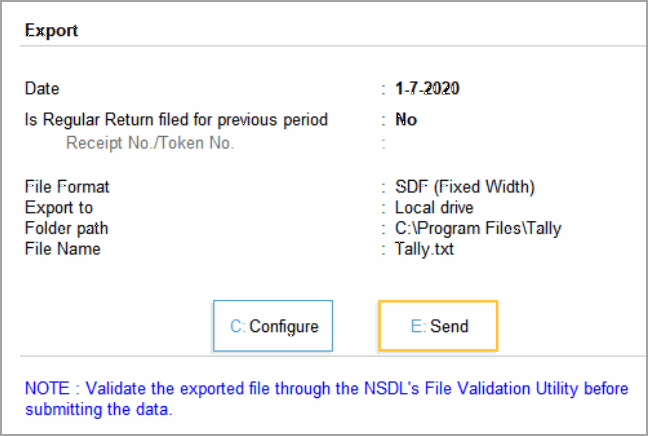

Export Form 27EQ
You can export Form 27EQ in the text format.
For e-TCS returns for periods up to 31 March 2026, export Form 27EQ. For periods on or after 1 April 2026, export Form 143.
  2. Press Alt+B (Save Return).
    Form 27EQ can be exported only after it is saved. The report closes after it is saved, so reopen Form 27EQ.
  3. Press Alt+E (Export) > E-Return.
  4. In the Export Report screen, select the required File Format. It is SDF (Fixed Width) by default.
  5. Specify the Folder path.
  6. Press Enter to export the data.
    Export Form 27EQ in TallyPrime

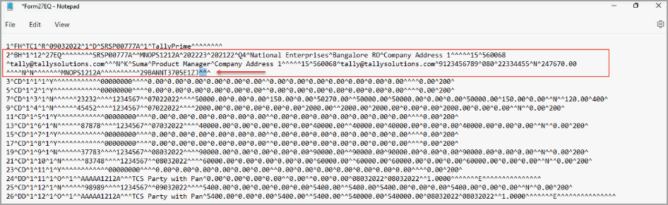

Update Form 27EQ Text File as per FVU 7.5/7.6
The FVU 7.5/7.6 requirements introduced two new fields in the batch header for Section 194P.
These fields are not applicable to Form 27EQ.
  • Field 70: Count of Section 194P Details Record
  • Field 71: Batch Total of Gross Total Income as per Section 194P Details
  1. Export the Form 27EQ text file.
    1. In Form 27EQ, press Alt+E (Export) > E-Return.
    2. In the Export screen, configure the Folder Path and select Send.
  2. Open the exported text file in Notepad.
  3. In the Batch Header (BH) line, after the GSTIN field, add two caret symbols ^^ for fields 70 and 71.
  4. Save the text file.

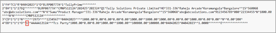

Update Form 27EQ Text File as per FVU 8.2
The FVU 8.2 requirements require updates to the Collectee Detail Record (DD) in the exported Form 27EQ text file.
Field 8: Collectee Code
Refer to Annexure 8 – List of Collectee Codes and update the applicable collectee code in field 8.
    1. In Form 27EQ, press Alt+B (Save Return).
    2. Press Alt+E (Export) > E-Return.
    3. In the Export screen, configure the Folder Path and select Export.
  2. Open the exported text file.
  3. In the Collectee Detail Record (DD) line, remove the value in field 8 and enter the applicable collectee code as per Annexure 8.

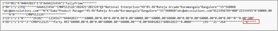

Field 49: Whether collectee opting out of taxation regime u/s 115BAC (1A)?
Field 49 is mandatory for statements pertaining to FY 2023–24 onwards. Enter Y or N based on applicability.
  2. Open the exported file.
  3. In the Collectee Detail Record (DD) line, update field 49 with Y or N.
