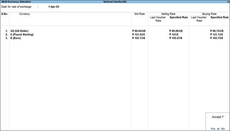

Set Up Forex Rates for Multi-Currencies
  1. Press Alt+G (Go To) > type or select Chart of Accounts and press Enter > type or select Currencies and press Enter.
  2. Press Alt+H (Multi-Masters) > Rate of Exchange and press Enter.
  3. Provide the details of forex rates.
    1. Std Rate: Enter the standard rate of exchange.
    2. Selling Rate: Enter the rate used while selling.
    3. Buying Rate: Enter the rate used while buying.
      Set up forex rates for multiple foreign currencies in TallyPrime
  4. Press Ctrl+A to save.
Transactions will use the exchange rates based on the date of applicability.
