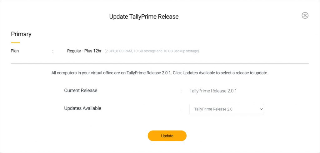

  2. Take a backup of the data available on TallyPrime on AWS using the Computer and User Management portal.
    • Download the backed-up data to your local computer.
  3. From the Computer and User Management portal, upgrade to the latest release.
    Refer to the Update to TallyPrime Releases section for more details.
  4. Start the latest release of TallyPrime on the virtual computer, select the company and migrate.
    On successful migration, you can continue using the company data as usual.

  5. From the Computer and User Management portal, upgrade to the latest release.
  6. Start the latest release of TallyPrime on the virtual computer, select the migrated company data (6-digit company) > press Enter, and continue to use the data as usual.
TallyPrime on AWS does not support co-existence of different releases of TallyPrime on the virtual computer. After migration, in case you would want to continue to access the data using the the earlier release of TallyPrime, perform the following:
– From the Computer and User Management portal, select the applicable release (for example, TallyPrime Release 5.1).
– Access the 5-digit source company data and continue to use the data as usual.
If you are an administrator or owner, and you have a valid TSS, you can update TallyPrime to any of the available releases on the virtual computer.
  1. On the Computer & User Management portal, under Action against the account name, click the ellipse sign (…), and select Update TallyPrime.
    In the current release of Virtual Computer Connection, your virtual computer will be on the latest release of TallyPrime and TallyPrime Server (Release 4.0).
    update-tally-release
    Once releases later than 4.0 are available, you can select the respective release to update.
  2. From the Update to TallyPrime release drop-down list, select a TallyPrime release that you want to update to.
  3. Click Update.
    A message appears prompting you to confirm the update. On confirmation, the TallyPrime application on your virtual computer gets updated to the selected release.
