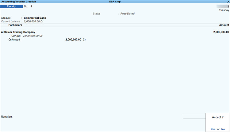

Receipt of funds | Current & Post-Dated
Create receipt vouchers when you receive the payment for your party. Mark the voucher as post dated if the payment is expected in a future date.
While recording a receipt voucher:
  1. Select the account through which you receive the payment from your party. For example, Cash or your company’s bank account ledger.
  2. Enter the amout received under the Amount column.
  3. If the amount is expected to be received in a future date, press Ctrl+T (Post-Dated).
    Ths Status of the receipt voucher is marked as Post-Dated.
  4. Provide other necessary information and press Ctrl+A to save.
