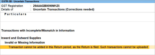

Transaction cannot be added in this Return period, as the Return is filed. Such transactions cannot be uploaded
Cause
If you have already signed the return, and then create a voucher with a date within the same return period, then this uncertain transaction appears in GSTR-1 and GSTR-3B: Transaction cannot be added in this Return period, as the Return is filed.

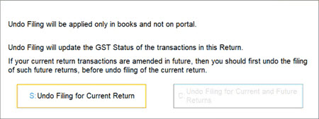

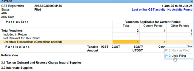

However, if returns are just marked as filed or signed, then you can undo filing for the current return.
  1. Open GSTR-1/GSTR-3B and press Alt+F10 (Undo Filing).
  2. Press S (Undo Filing for Current Return).
The transaction now becomes a part of the return.
