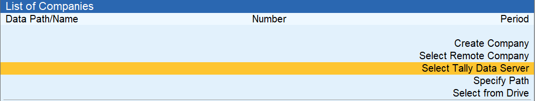

Use TallyPrime Server data path instead of shared data path (TPCA)
In TPCA environments (such as TP on AWS/OCI), ensure that data is stored in the TPS_Data folder instead of Shared_Data, as storing data in Shared_Data can impact the performance of TallyPrime Server.

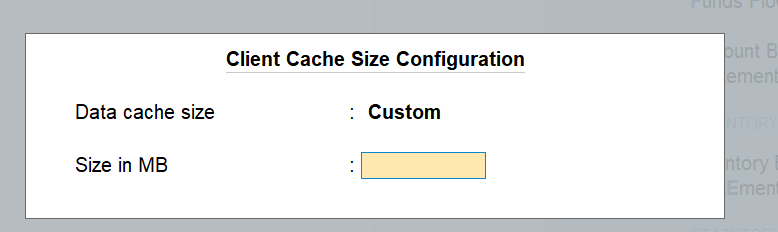

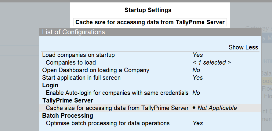

Cache size in TPCA
 In TPCA (AWS/OCI) environments, you can check the cache size configuration in TallyPrime.
If it shows Not Applicable, the cache is automatically set to 20% of RAM (or 8 GB, whichever is lower) for both Admin and standard users.
In such cases, you can configure a custom cache size (in MB) with a reduced value, based on the number of users accessing the computer and the RAM allocated to the VM. This helps achieve optimised performance, using the cache size calculation formula mentioned below.
Use local VM folder path for exports or print rather than mapped path
If you are using a local folder path mapped as a drive in a cloud VM for Tally exports or Print to PDF [RV7.1], it may impact performance or cause the service to crash, as Tally needs to write data over the internet (especially if the connection is slow). It is recommended to export files to a local cloud drive first and then copy them to your system separately.

Cache size
You can utilise the configuration of high or custom to optimise the performance during data entry or report viewing operations.
Configuring Cache size
  1. Press F1 (Help) > Settings > Startup > Show More.
  2. Under TallyPrime Server, enable Cache Size for accessing data from TallyPrime Server.
    This configuration allocates additional RAM in the machine where TP is running.
  3. Press Ctrl+A to save the changes.
Custom option
The system considers data size in bytes. In pre-7.0 releases, although Size in MB is displayed on screen, the value must be given in bytes.
Ex: For 2 GB, the value in bytes as (2* 1024*1024*1024), which is 2147483648.
Apply the increase in cache size in systems with sufficient RAM size because the cache will be using physical RAM in the local system where TP is running.
Ram size can be between 15MB and up to 8GB in the custom option.
When TallyPrime and TallyPrime Server are on the same computer, ensure that the total cache consumption stays within 20% of the RAM (this is a conservative limit to prevent full RAM utilisation).
Formula:
Cache per instance = 20% of (Total RAM) ÷ (Number of Users × Average Tally instances per user)
Example:
Total RAM = 32 GB, Number of Users = 8, Average Tally instances per user = 2,
Then, 6.4 GB ÷ 16 ≈ 400 MB per instance

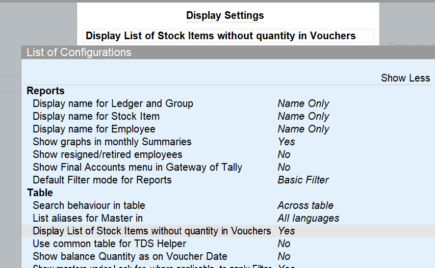

Enable the display list of stock items without quantity option
By enabling this option, users can improve the performance while creating or altering vouchers with stock items, as TallyPrime does not need to calculate the balances for showing the quantity in the List of Stock Items.
  1. Press F1 (Help) > Settings > Display.
  2. Under Table, enable the option Display List of Stock Items without quantity in Vouchers.

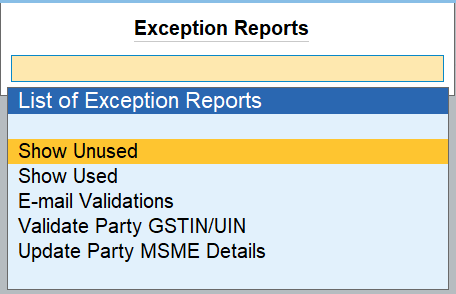

Unused masters
If your business has a large number of unused masters, review and delete them to help optimise overall performance.
To check unused masters: Go To > Chart of Accounts > Ledgers > Exception Reports > Show Unused.
Avoid simultaneous access of data via TallyPrime Server and via local path
In TallyPrime, users typically access data through TallyPrime Server using the Select Tally Data Server option. However, if some users simultaneously access the same company data through a local path, it can impact performance. Therefore, it is recommended to always access the company data only via TallyPrime Server.
