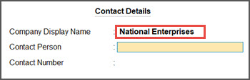

Cause 2:
The Company Display Name mentioned in the Contact Details of the Server and the Company Name in the Client rule are different.
Resolution 2:
In the Client Rule for Company Display Name, the Company Name on the Client Rule should be similar to the Company Display Name mentioned in the Contact Details of the Server.
  1. Press Alt+K (Company) from Gateway of Tally > Online Access > Contact Details and press Enter.
    You can see the Company Display Name appearing under Contact Details.
    contact-details-screen

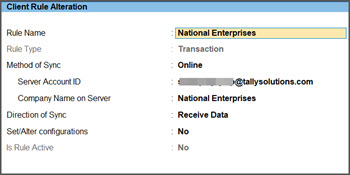

  2. Press Alt+Z (Exchange) > All Sync Options > Client Rules > Alter.
  3. In the Client Rule Alteration screen, update the Rule Name as per the Company Display Name and save.
    company-name-client-rule

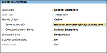

Cause 3:
The Server Account ID is incorrect in the Client Rule.
Resolution 3:
  1. Press Alt+Z (Exchange) > All Sync Options > Client Rules > Alter.
  2. In the Client Rule Alteration screen, update the correct Server Account ID and save.
    server-acc-id

Cause
This issue arises due to the mismatch in Company Display name in the client rule on the server and the Company Display name displayed in the server system.
Solution
  1. Press Alt+K (Company) > Configure > Online Access.
  2. Alter the Company Display Name in the server system.
  3. Enter the same name in the Client rule company name on the server.
Press Enter to save the rule, and then continue synchronizing the data.
