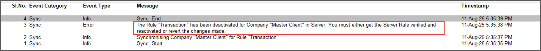

Cause
This message is displayed when the option Deactivate when Client Rule changes is enabled in Server Rule, and any changes are made to the existing Client Rule.
Solution
Verify the Client Rule and set the option Activate to Yes in Server Rules to continue data synchronisation.
