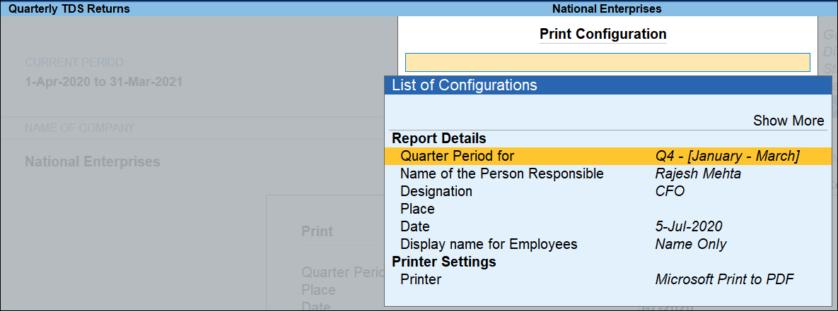

Annexure II has to be filed along with Form 24Q only in the last Quarter (4th Quarter).
To print Annexure II
  1. Gateway of Tally > Display More Reports > Payroll Reports > Statutory Reports > Income Tax > Annexure II to Form 24Q.
  2. Press C (Configure) to specify the details as shown in the Print Configuration screen:
  3. Press P (Print) to print Annexure II to Form 24Q.
