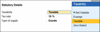

  3. Update the Statutory Details.
    1. Press F12 (Configure) and enable Set Nature of Transaction for Ledgers.
    2. Select the Nature of transaction or select Not Applicable for the system to decide or select the required Nature of transaction.
    3. Taxability is set to Taxable by default, as defined at the company level. Change the Taxability to Not Vatable, Exempt, or Zero Rated, as required.

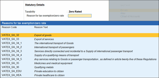

    4. Update the Reason for tax exemption/zero rate, if you have set Taxability as Not Vatable, Exempt, or Zero Rated.
      Reasons for tax exemptions
